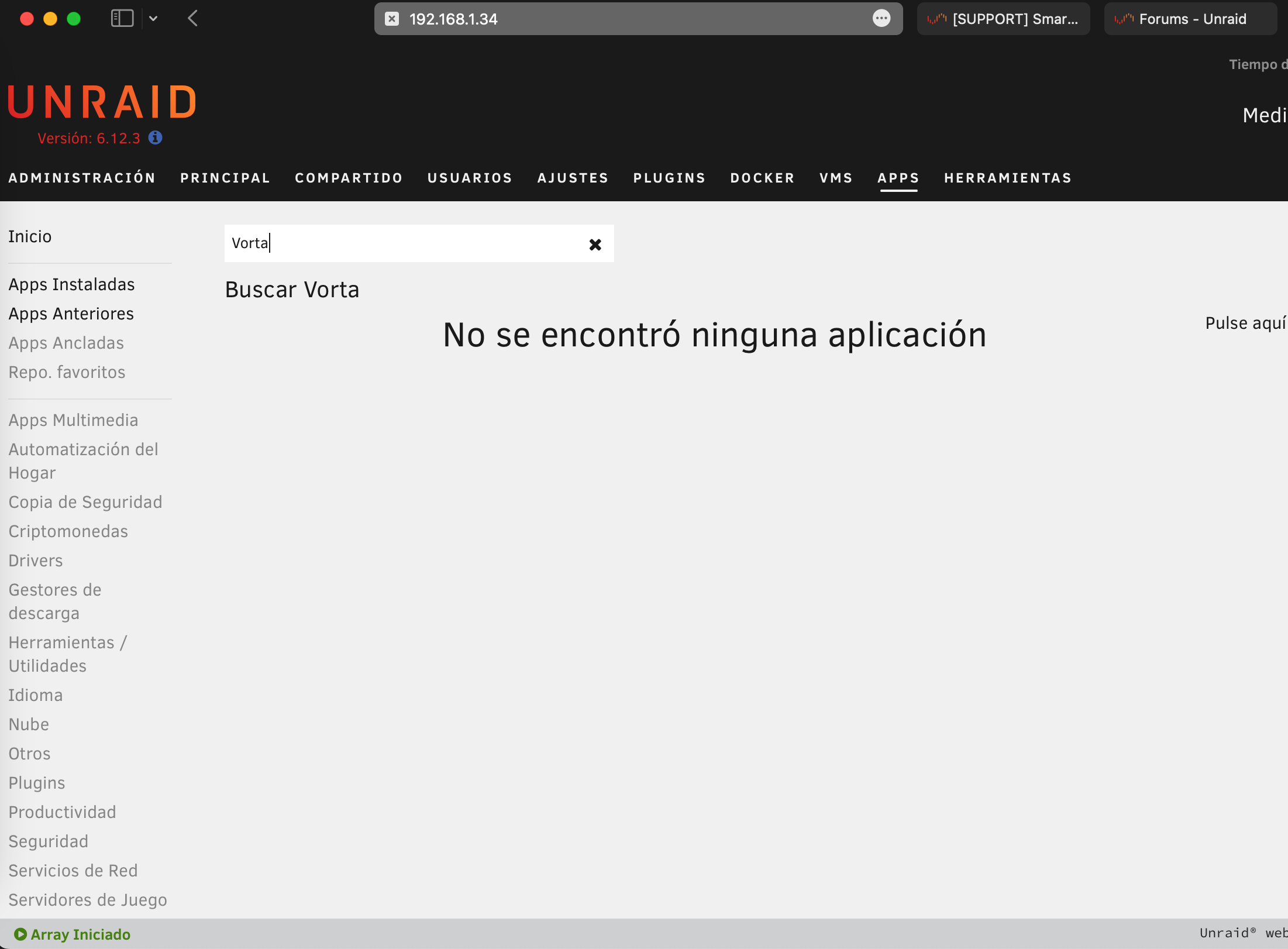

Vorta doesn't appear in the UnRAID appcenter search, how could I download it?
Will it show up there again?
I would really like Vorta because it has a graphical interface and I don't have deep computer knowledge.

Hmm, I was recommending this Vorta container to someone and they didn’t find it. I can’t either anymore, where did it go?
Can't find it under apps, maybe the template isn't being maintained anymore?
The docker image is available on the repository ghcr.io/borgbase/vorta-docker

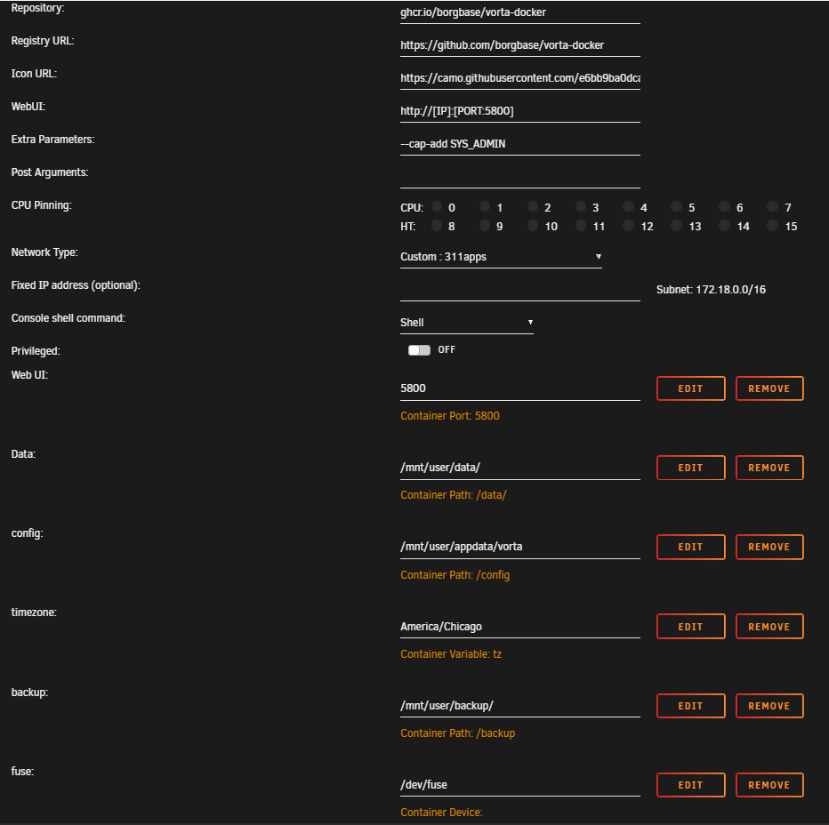

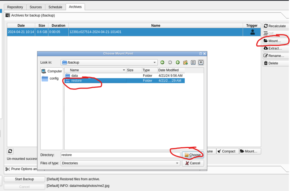

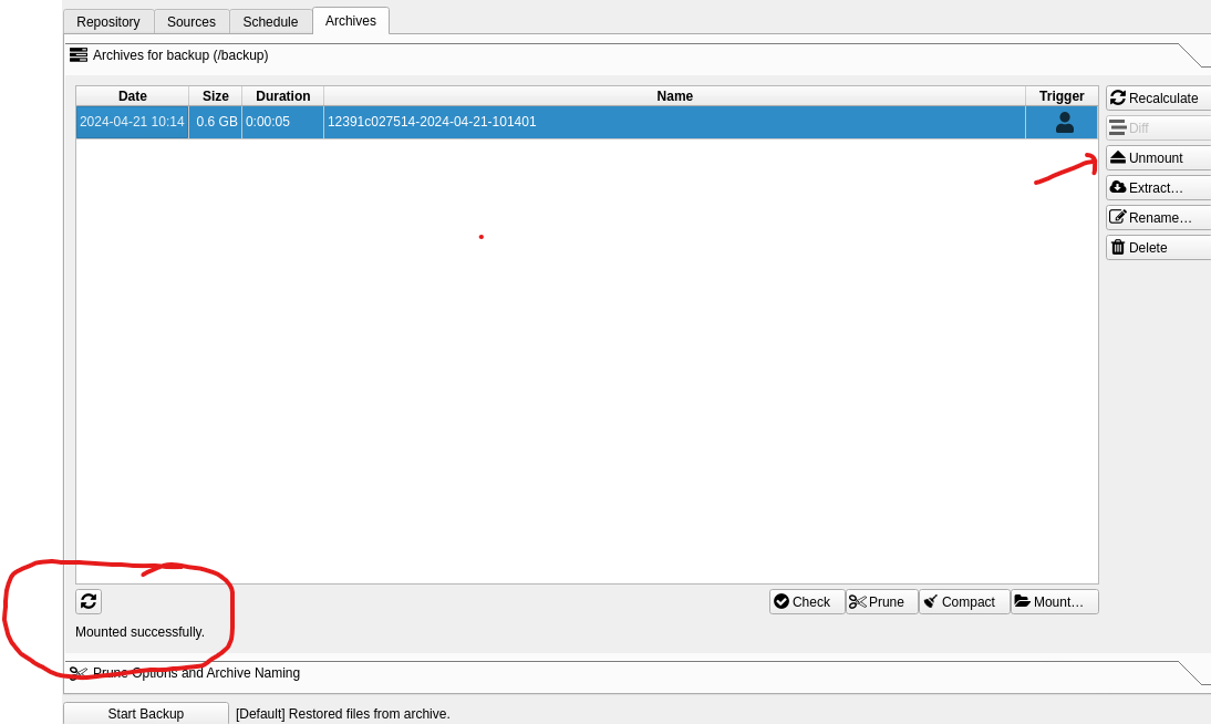

I have Vorta running on Unraid and backups are working and I can extract (restore) files.  However I cannot get the Mount option to work so that I can mount the whole archive as a folder.  I added the device /dev/fuse and --cap-add SYS_ADMIN to extra parameters.
This is what Im doing.  Going to the archive, selecting the Mount option and then created a restore folder in my backup share.  (mounted r/w).
I get this "Mounted succesffuly" message at the bottom and the Mount option changes to unmount
But there are no files in the restore folder:
This is my docker setup:
Hi @pharpe, not sure if you still have this issue but if anyone else tries to mount it, according to the docker devs (assuming you're using the one from https://github.com/borgbase/vorta-docker), it'll only show up in the container, you can view it by "mounting" another archive and go to the same folder you mounted it to. Although in my opinion I'd rather mount and restore on a different machine.
Hopefully you've already figured this out, but I'll write the answer here for future prosperity.
When you want to mount the restore path you need to first stop the container and re-deploy it, but as privileged (default = off)
