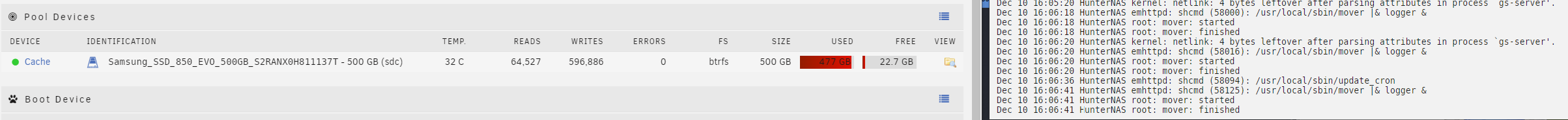

Latest version of unRaid.  I'm copying a LOT of files via SMB (windows 10 to unRaid share) which works great.  I have 500gb Cache drive, but the drive is filling up and then windows copy hangs.  I thought that once the cache disk fills up, that it would skip cache and write directly (but slower) to the physical drive.  Am I misinformed?  Is there a setting somewhere I've missed?  Mover is set to execute every 3 hours.

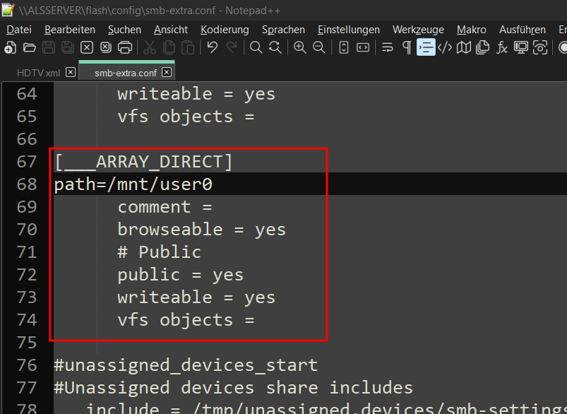

Thanks!  I was aware of User0, however, I thought that resulted in slower performance copying the files?  Probably not a big deal.  I get 113MB/s with the cache.  Also, how would I setup the User0 disk for an SMB share from Windows 10?  I don't see that option in the included disks.

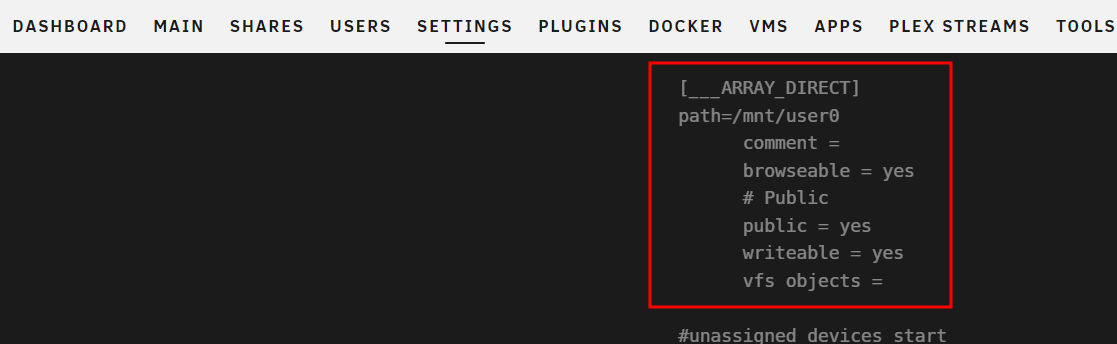

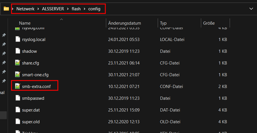

something like this
will result in

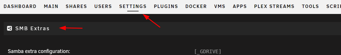

you can do this in real time (without stopping the array) by editing this file on your flash drive, BUT ON YOUR OWN RISK ;) thats what i just did  to show ;)
this is not recommended, rather stop the array and use the SMB extra part in settings ;)

Diagnostics attached.  I think I didn't fully understand some of the settings.  Specifically Cache-prefer - didn't realize that would prefer to leave the files on the cache, I thought it meant use the cache unless full...  I physically moved the files myself using MC, so good for now.  I've looked at all the shares, they are either Cache-yes (for shares that don't have huge files - documents, music, movies, etc) and Cache-no for very large files (like PC backups) which now go directly to share.  I'm having a problem where the server runs for a few days then locks up.  I suspect it an unrelated logging issue but I'm not sure.  I see a lot of these in the log...
Dec 24 10:00:30 HunterNAS kernel: netlink: 4 bytes leftover after parsing attributes in process `gs-server'.
