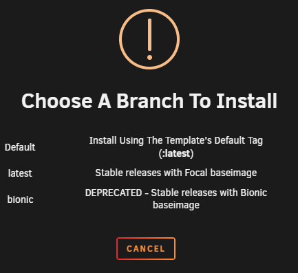

hello I'm with version 6.10.0-rc2 of unraid and tried to install Plex from the indicated repository and it's giving this message.
I'm new to unraid, you know how to solve it.
My Processor is Intel® Core™ i3-10100 Intel® 630 UHD Graphics.
Thanks.
none of these repositories have the option of decoding by graphic intel

Did you figure it out?
Because you have to do manual configuration to configure and enable iGPU/QSV hardware encoding in Plex, Emby, HandBrake, etc.
See this forum discussion for details.
Note: there are different ways to load the i915 drivers depending on which version of unRAID you are using.
