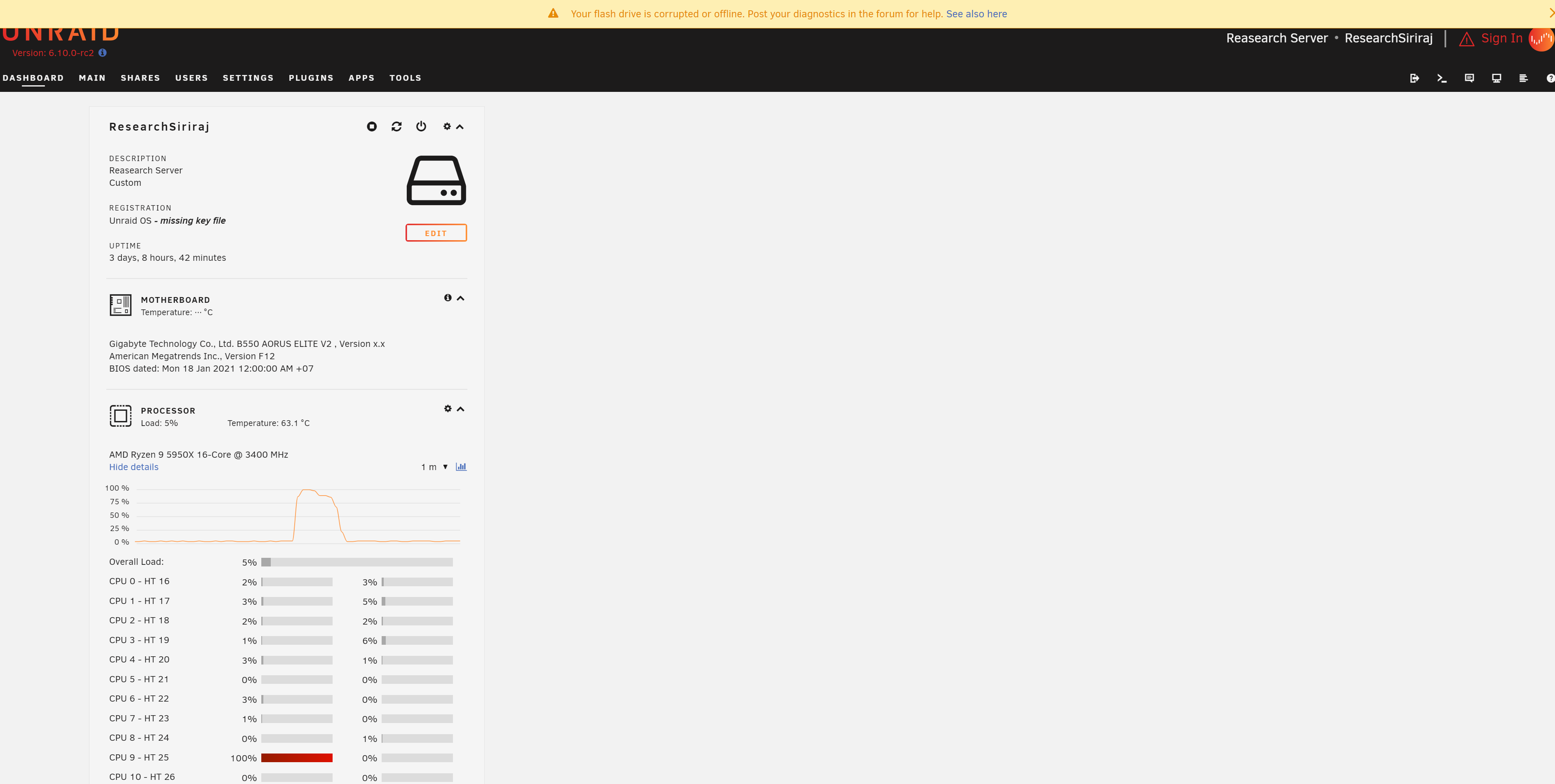

I have an issue with my docker container causing unraid critical file to be pushing out of the memory. Then most of service starting to error.
This issue is only occur in this server, I have tried this deployed this images in other of my unraid server and it behave normally. I suspected that it might be a bad boot flash maybe? Here a diagnostics file and error screen.
Where are you seeing that? All I see is flash drive issues.
Put flash in PC and checkdisk. While there make a backup. Boot from USB2 port.
Thanks for the reply!
Here syslog before all the service went down.
I will take a look at the boot flash when I visit the datacenter, maybe replacing the boot flash.
Can you confirm is it a bad boot flash or other issue? Thank you in advance.
