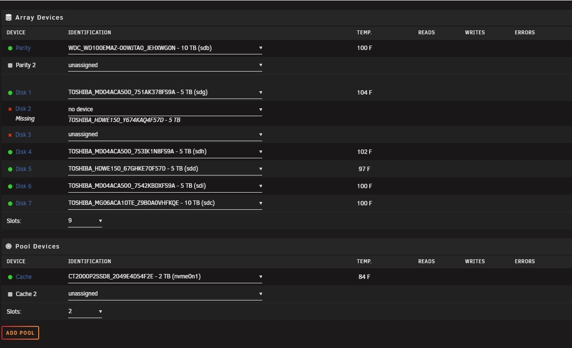

I booted up and see the new 14TB drive, but now another drive has gone missing.  I've fussed with power and sata cables, rebooted several times and cannot get the newly failed drive to come back up.
So how do I re-install my 4TB drive that has read errors, but at least is working back into its slot?
I think if I can do this, I can complete the parity swap with the newly failed drive, then after that is done use my second 14TB drive to swap out the original 4TB drive with read errors.
I think I can re-install the 4TB drive, then assign it to the proper slot and say yes this is correct?  I think I've done that before, but wanted to ask before making things worst.

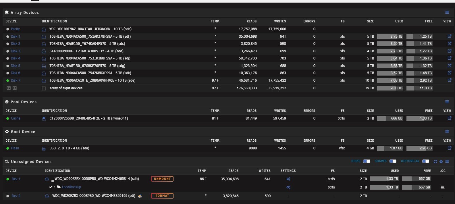

A couple pictures. One before, one after.

New Config with Maintenance Mode and Valid Parity both checked is the way we usually go to get a different disk disabled and rebuilt. Never tried that with Parity Swap though it seems like it should work. Let's see what @JorgeB thinks
Even if we can go that way though, you would need a disk that could be assigned to that slot, so that slot could then be unassigned after New Config to disable it.
Do you have any other disk not larger than current parity that would work well enough that you could assign to that slot? Doesn't matter at all what is on it as long as it can be detected and of course isn't a disk already assigned to the array.
There is also a command line method to get it to rebuild a different disk, but I haven't thought of any way to combine that with parity swap.

Since you apparently had more than one disk with problems, I have to wonder if any of your other disks have problems also. Parity by itself, of course, can rebuild nothing. Every bit of all other disks must be reliably read to reliably rebuild every bit of a disk.
Attach Diagnostics to your NEXT post in this thread (probably the longest I have gone in a thread before asking for that).
I'm at a complete loss now.  After rebooting several times trying to get he 5TB drive to come up.  I gave up and hooked in the 4tB drive again.
When I boot I now see the 4TB drive, but another 5TB drive is gone.
I've attached diagnostics in case someone can spot something.
