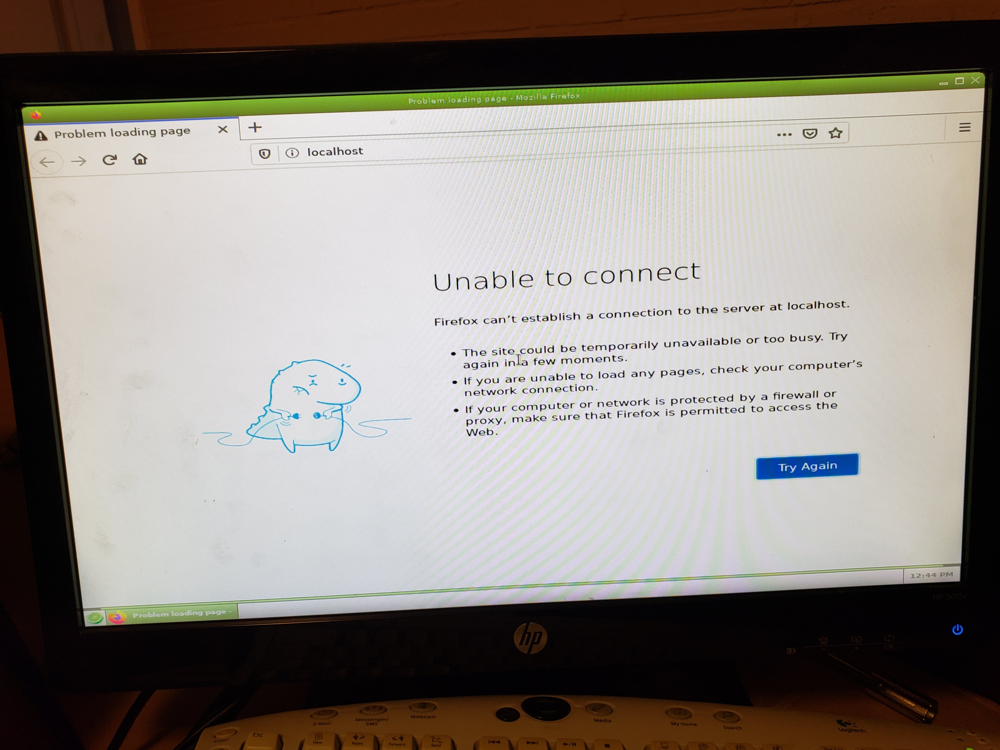

unable to access local host from the GUI
I am having trouble loading into the main menu, ones i get to the menu, start it in GUI mode, and log in as root. It shows it cant connect to the local host.  I have already delete the network, and network rules file, from the config file, to reset them, and nothing helped. tried to delete and replace files from a working usb stick, and still nothing.
Im trying to keep the save USB stick, with all the save data, so I dont have to re-setup my array/pools/apps, and lose any data on the array.
Any help would help out alot.

  1. Wait a couple of minutes before trying to log in. -> It's a quirk and a bit pet peeve of mine that if you're sitting in front of that screen and you see the login screen and immediately log in you will see exactly what you're seeing.  Try again in a few minutes.  Or,
  2. From the start menu (the "lime"), go to the terminal and type in
    diagnostics
    and then
    powerdown
    and after the system has shut off, post the resulting zip file that was stored within /logs on the flash drive (pull the flash drive and put it into another computer)
Boot in SAFE mode
Looks like your go file is corrupt.
Do you have a backup of flash?
Have you allowed access to your server from outside your network?
no to both questions
Put flash in your PC and checkdisk. While there make a backup. You will at least have to replace the config/go file with one from a fresh download.
Boot from USB2 port
replaced the go file. and moved to a different usb drive. seem to work now. THANK you guys
