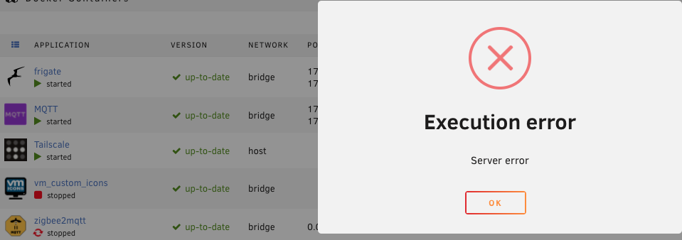

Execution Error (server error)
Hi trying to install Zigbee2mqtt  after following didiblurDIY comprehensive instruction for my Conbee11 -Stick.
 The issue is that i receive error message as below . I have checked config file and is good . The only issue i had was find the ls /dev/serial/by-id/ a sit came up with no such directory, however i was able to find the path in HA supervisor hardware section.
 Any help & guidence would be appreciated.
If you link a empty path for a device the container can't start, please post a screenshot from your template and maybe from your docker run command (it will appear after you click on Apply on the Docker template page and there you will also see the actual error message why it wouldn't start).
I also would recommend to post in the Docker support thread for this Container.
