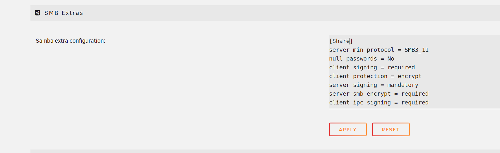

So I stopped the array, modifed the config as per the following screenshot and applied it:
Then started the array.
When browsing to \\server\ I can no longer see the share
Additionally, I am still not seeing SMB3 traffic, but rather SMB2 (viewing the traffic in wireshark)
Curiously, if I change the label from [Share] to [global] I can once again see \\server\share\ but alas, that's still being accessed via SMB2 as well :(
