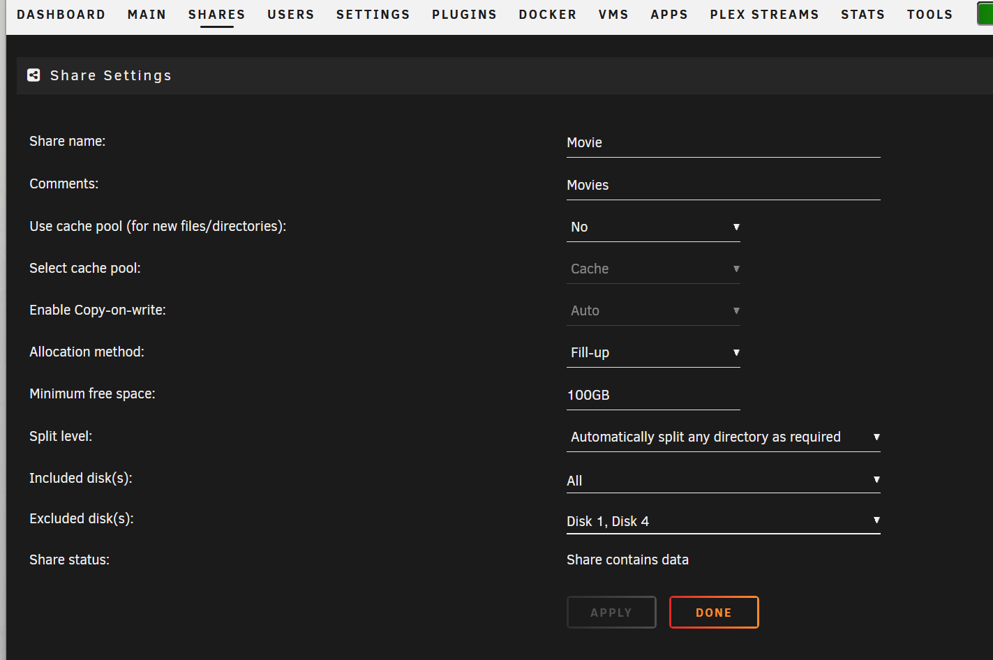

I created a share folder with the "Use cache pool" setting to No. However, when I copy or move files to the share and view the share folders, I see those files residing on both the array and one of my cache pools.
I attempt to run mover but nothing appears to happen. I didn't expect it to since the share is set to not use any cache pools.
How do I about troubleshooting?
Thanks.
Solved by itsecmonkey
array disks are part of user shares, and pools are part of user shares. Any setting you make to a user share only applies to new files, and nothing gets moved except according to mover settings. So if the share was cache-yes or cache-prefer, setting it to cache-no will only write new files directly to the array, and will not move anything since mover ignores cache-no and cache-only shares.

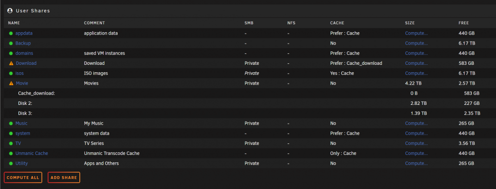

I need a bit of help.
In having a slimier problem.
Ive assign Cache Pool on my Download share but if Ive move a file from the Download share folder to the Array the file still on the Cache Pool even the Array are not share doesn't assign under the Cache Pool.
How do i resolve this.
Ive try to delete the file from the array and there are still error report that some of the files are unprotected and i notice that the Cache Pool still assigned to that Share.
ts-s20-diagnostics-20220101-2156.zip
How did you move the file?   Depending on how you moved it you may be falling found of this quirk of how User Shares can interact with the Linux level underlying Unraid.
