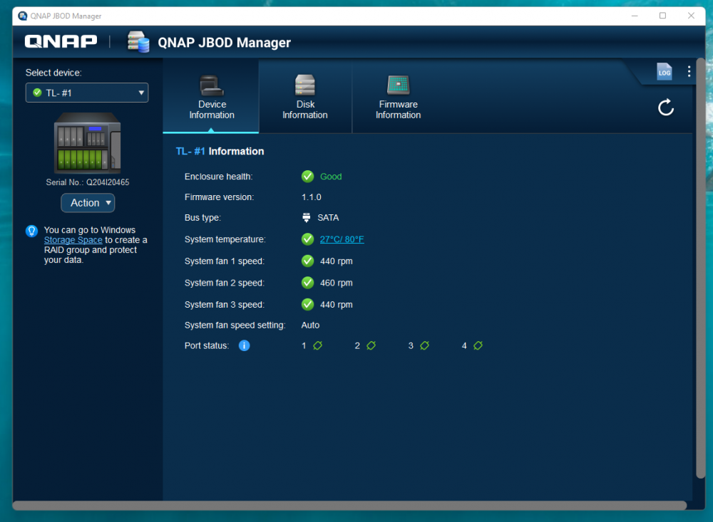

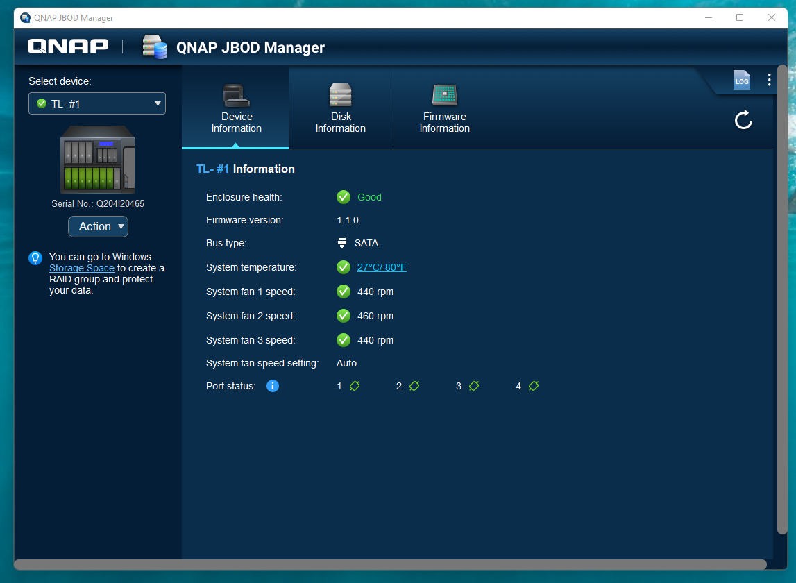

I've pulled the expansion card and connected it to my windows PC. The QNAP boots and starts beeping as it starts to test each cable connection. I'm now getting green lights on the drives. So the enclosure and the expansion card appear to be working now. The enclosure recognizes my desktop as the host device.

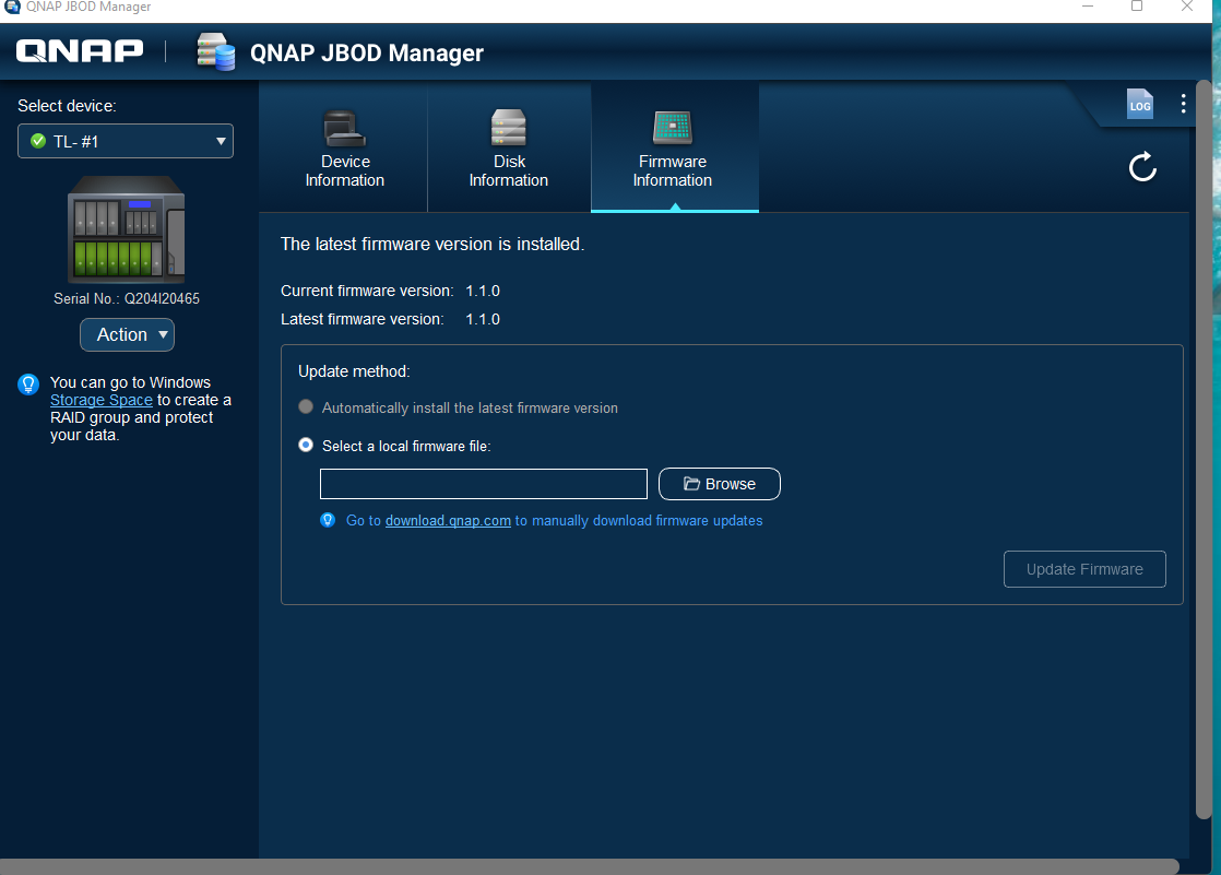

Yes I have the 1600es card.  I'm guessing I should point out that if I'm having to ask these questions I've hit the end of my knowledge. Thank you very much for chiming in but what does that mean with it being Marvel based?  Are we saying I'm not dead in the woods yet?  I've just updated its firmware through my windows PC. Not sure what my options are next.
It appears to be detecting the drives all fine now and the firmware is the latest.

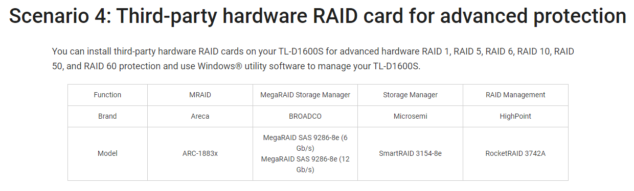

https://www.qnap.com/en/product/tl-d1600s
As enclosure officially work with other HBA, so it should work if you change supported controller with Unraid.
To minimize the cost, you can use your mobo SATA port with "SFF-8088 <-> SATA reverse cable" to test. Or LSI HBA with connect converter to connect SFF-8088 ( enclosure socket )
