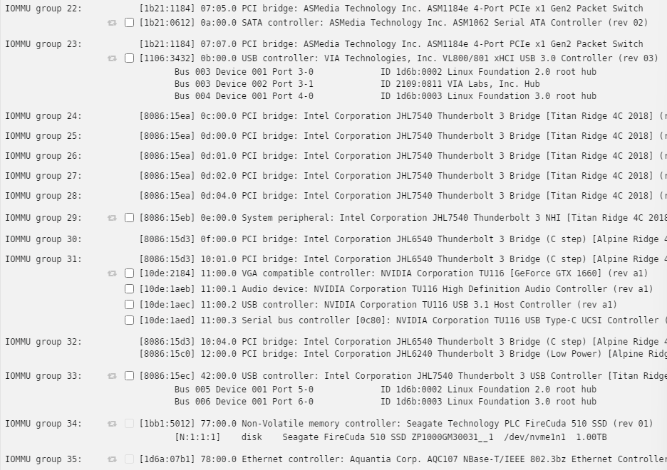

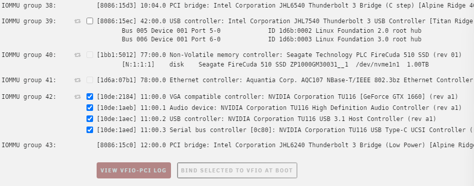

At the moment I have IOMMU 31 and 33 binded to VFIO at boot in multi-dunction ACS override.
IOMMU group 0:[8086:9b33] 00:00.0 Host bridge: Intel Corporation Device 9b33 (rev 05)
IOMMU group 1:[8086:1901] 00:01.0 PCI bridge: Intel Corporation 6th-10th Gen Core Processor PCIe Controller (x16) (rev 05)
[8086:1905] 00:01.1 PCI bridge: Intel Corporation Xeon E3-1200 v5/E3-1500 v5/6th Gen Core Processor PCIe Controller (x8) (rev 05)
[1000:0087] 01:00.0 Serial Attached SCSI controller: Broadcom / LSI SAS2308 PCI-Express Fusion-MPT SAS-2 (rev 05)
[1:0:0:0] disk ATA WDC WD6001FFWX-6 0A81 /dev/sdb 6.00TB
[1:0:1:0] disk ATA ST6000VN0001-1SF AN02 /dev/sdc 6.00TB
[1:0:2:0] disk ATA ST6000VN0001-1SF AN02 /dev/sdd 6.00TB
[1:0:3:0] disk ATA Samsung SSD 840 BB6Q /dev/sde 250GB
[1:0:4:0] disk ATA ST6000VN0033-2EE SC60 /dev/sdf 6.00TB
[1000:0087] 02:00.0 Serial Attached SCSI controller: Broadcom / LSI SAS2308 PCI-Express Fusion-MPT SAS-2 (rev 05)
[8:0:0:0] disk ATA ST6000NM0115-1YZ SN04 /dev/sdg 6.00TB
[8:0:1:0] disk ATA ST6000VN0001-1SF AN02 /dev/sdh 6.00TB
[8:0:2:0] disk ATA TOSHIBA MQ01ABD1 2C /dev/sdi 1.00TB
[8:0:3:0] disk ATA WDC WD6001FFWX-6 0A81 /dev/sdj 6.00TB
[8:0:4:0] disk ATA WDC WD6002FRYZ-0 1M02 /dev/sdk 6.00TB
[8:0:5:0] disk ATA WDC WD6001FFWX-6 0A81 /dev/sdl 6.00TB
IOMMU group 2:[8086:9bc5] 00:02.0 VGA compatible controller: Intel Corporation CometLake-S GT2 [UHD Graphics 630] (rev 05)
IOMMU group 3:[8086:1911] 00:08.0 System peripheral: Intel Corporation Xeon E3-1200 v5/v6 / E3-1500 v5 / 6th/7th/8th Gen Core Processor Gaussian Mixture Model
IOMMU group 4:[8086:06f9] 00:12.0 Signal processing controller: Intel Corporation Comet Lake PCH Thermal Controller
IOMMU group 5:[8086:06ed] 00:14.0 USB controller: Intel Corporation Comet Lake USB 3.1 xHCI Host Controller
Bus 001 Device 001 Port 1-0 ID 1d6b:0002 Linux Foundation 2.0 root hub
Bus 001 Device 002 Port 1-1 ID 0658:0200 Sigma Designs, Inc. Aeotec Z-Stick Gen5 (ZW090) - UZB
Bus 001 Device 004 Port 1-6 ID 174c:2074 ASMedia Technology Inc. ASM1074 High-Speed hub
Bus 001 Device 005 Port 1-7 ID 045e:00db Microsoft Corp. Natural Ergonomic Keyboard 4000 V1.0
Bus 001 Device 006 Port 1-6.3 ID 046d:c52b Logitech, Inc. Unifying Receiver
Bus 001 Device 007 Port 1-9 ID 174c:2074 ASMedia Technology Inc. ASM1074 High-Speed hub
Bus 001 Device 008 Port 1-6.4 ID 0781:5583 SanDisk Corp. Ultra Fit
Bus 001 Device 009 Port 1-11 ID 413c:3012 Dell Computer Corp. Optical Wheel Mouse
Bus 001 Device 010 Port 1-13 ID 26ce:01a2 ASRock LED Controller
Bus 001 Device 011 Port 1-14 ID 8087:0029 Intel Corp.
Bus 001 Device 012 Port 1-3 ID 045e:02fe Microsoft Corp. XBOX ACC
Bus 002 Device 001 Port 2-0 ID 1d6b:0003 Linux Foundation 3.0 root hub
Bus 002 Device 002 Port 2-6 ID 174c:3074 ASMedia Technology Inc. ASM1074 SuperSpeed hub
Bus 002 Device 003 Port 2-9 ID 174c:3074 ASMedia Technology Inc. ASM1074 SuperSpeed hub
[8086:06ef] 00:14.2 RAM memory: Intel Corporation Comet Lake PCH Shared SRAM
IOMMU group 6:[8086:06e0] 00:16.0 Communication controller: Intel Corporation Comet Lake HECI Controller
[8086:06e3] 00:16.3 Serial controller: Intel Corporation Comet Lake Keyboard and Text (KT) Redirection
IOMMU group 7:[8086:06d2] 00:17.0 SATA controller: Intel Corporation Comet Lake SATA AHCI Controller
IOMMU group 8:[8086:06c0] 00:1b.0 PCI bridge: Intel Corporation Comet Lake PCI Express Root Port #17 (rev f0)
IOMMU group 9:[8086:06ac] 00:1b.4 PCI bridge: Intel Corporation Comet Lake PCI Express Root Port #21 (rev f0)
IOMMU group 10:[8086:06b9] 00:1c.0 PCI bridge: Intel Corporation Device 06b9 (rev f0)
IOMMU group 11:[8086:06bb] 00:1c.3 PCI bridge: Intel Corporation Device 06bb (rev f0)
IOMMU group 12:[8086:06bc] 00:1c.4 PCI bridge: Intel Corporation Device 06bc (rev f0)
IOMMU group 13:[8086:06b0] 00:1d.0 PCI bridge: Intel Corporation Comet Lake PCI Express Root Port #9 (rev f0)
IOMMU group 14:[8086:06b4] 00:1d.4 PCI bridge: Intel Corporation Device 06b4 (rev f0)
IOMMU group 15:[8086:0697] 00:1f.0 ISA bridge: Intel Corporation Device 0697
[8086:06c8] 00:1f.3 Audio device: Intel Corporation Comet Lake PCH cAVS
[8086:06a3] 00:1f.4 SMBus: Intel Corporation Comet Lake PCH SMBus Controller
[8086:06a4] 00:1f.5 Serial bus controller [0c80]: Intel Corporation Comet Lake PCH SPI Controller
IOMMU group 16:[1bb1:5012] 03:00.0 Non-Volatile memory controller: Seagate Technology PLC FireCuda 510 SSD (rev 01)
[N:0:1:1] disk Seagate FireCuda 510 SSD ZP1000GM30031__1 /dev/nvme0n1 1.00TB
IOMMU group 17:[1000:0087] 04:00.0 Serial Attached SCSI controller: Broadcom / LSI SAS2308 PCI-Express Fusion-MPT SAS-2 (rev 05)
[9:0:0:0] disk ATA TOSHIBA MK1234GS 1J /dev/sdm 120GB
IOMMU group 18:[8086:15f2] 05:00.0 Ethernet controller: Intel Corporation Ethernet Controller I225-LM (rev 02)
IOMMU group 19:[1b21:1184] 06:00.0 PCI bridge: ASMedia Technology Inc. ASM1184e 4-Port PCIe x1 Gen2 Packet Switch
IOMMU group 20:[1b21:1184] 07:01.0 PCI bridge: ASMedia Technology Inc. ASM1184e 4-Port PCIe x1 Gen2 Packet Switch
[8086:2723] 08:00.0 Network controller: Intel Corporation Wi-Fi 6 AX200 (rev 1a)
IOMMU group 21:[1b21:1184] 07:03.0 PCI bridge: ASMedia Technology Inc. ASM1184e 4-Port PCIe x1 Gen2 Packet Switch
IOMMU group 22:[1b21:1184] 07:05.0 PCI bridge: ASMedia Technology Inc. ASM1184e 4-Port PCIe x1 Gen2 Packet Switch
[1b21:0612] 0a:00.0 SATA controller: ASMedia Technology Inc. ASM1062 Serial ATA Controller (rev 02)
IOMMU group 23:[1b21:1184] 07:07.0 PCI bridge: ASMedia Technology Inc. ASM1184e 4-Port PCIe x1 Gen2 Packet Switch
[1106:3432] 0b:00.0 USB controller: VIA Technologies, Inc. VL800/801 xHCI USB 3.0 Controller (rev 03)
Bus 003 Device 001 Port 3-0 ID 1d6b:0002 Linux Foundation 2.0 root hub
Bus 003 Device 002 Port 3-1 ID 2109:0811 VIA Labs, Inc. Hub
Bus 004 Device 001 Port 4-0 ID 1d6b:0003 Linux Foundation 3.0 root hub
IOMMU group 24:[8086:15ea] 0c:00.0 PCI bridge: Intel Corporation JHL7540 Thunderbolt 3 Bridge [Titan Ridge 4C 2018] (rev 06)
IOMMU group 25:[8086:15ea] 0d:00.0 PCI bridge: Intel Corporation JHL7540 Thunderbolt 3 Bridge [Titan Ridge 4C 2018] (rev 06)
IOMMU group 26:[8086:15ea] 0d:01.0 PCI bridge: Intel Corporation JHL7540 Thunderbolt 3 Bridge [Titan Ridge 4C 2018] (rev 06)
IOMMU group 27:[8086:15ea] 0d:02.0 PCI bridge: Intel Corporation JHL7540 Thunderbolt 3 Bridge [Titan Ridge 4C 2018] (rev 06)
IOMMU group 28:[8086:15ea] 0d:04.0 PCI bridge: Intel Corporation JHL7540 Thunderbolt 3 Bridge [Titan Ridge 4C 2018] (rev 06)
IOMMU group 29:[8086:15eb] 0e:00.0 System peripheral: Intel Corporation JHL7540 Thunderbolt 3 NHI [Titan Ridge 4C 2018] (rev 06)
IOMMU group 30:[8086:15d3] 0f:00.0 PCI bridge: Intel Corporation JHL6540 Thunderbolt 3 Bridge (C step) [Alpine Ridge 4C 2016] (rev 02)
IOMMU group 31:[8086:15d3] 10:01.0 PCI bridge: Intel Corporation JHL6540 Thunderbolt 3 Bridge (C step) [Alpine Ridge 4C 2016] (rev 02)
[10de:2184] 11:00.0 VGA compatible controller: NVIDIA Corporation TU116 [GeForce GTX 1660] (rev a1)
[10de:1aeb] 11:00.1 Audio device: NVIDIA Corporation TU116 High Definition Audio Controller (rev a1)
[10de:1aec] 11:00.2 USB controller: NVIDIA Corporation TU116 USB 3.1 Host Controller (rev a1)
[10de:1aed] 11:00.3 Serial bus controller [0c80]: NVIDIA Corporation TU116 USB Type-C UCSI Controller (rev a1)
IOMMU group 32:[8086:15d3] 10:04.0 PCI bridge: Intel Corporation JHL6540 Thunderbolt 3 Bridge (C step) [Alpine Ridge 4C 2016] (rev 02)
[8086:15c0] 12:00.0 PCI bridge: Intel Corporation JHL6240 Thunderbolt 3 Bridge (Low Power) [Alpine Ridge LP 2016] (rev 01)
IOMMU group 33:[8086:15ec] 42:00.0 USB controller: Intel Corporation JHL7540 Thunderbolt 3 USB Controller [Titan Ridge 4C 2018] (rev 06)
This controller is bound to vfio, connected USB devices are not visible.
IOMMU group 34:[1bb1:5012] 77:00.0 Non-Volatile memory controller: Seagate Technology PLC FireCuda 510 SSD (rev 01)
[N:1:1:1] disk Seagate FireCuda 510 SSD ZP1000GM30031__1 /dev/nvme1n1 1.00TB
IOMMU group 35:[1d6a:07b1] 78:00.0 Ethernet controller: Aquantia Corp. AQC107 NBase-T/IEEE 802.3bz Ethernet Controller [AQtion] (rev 02)

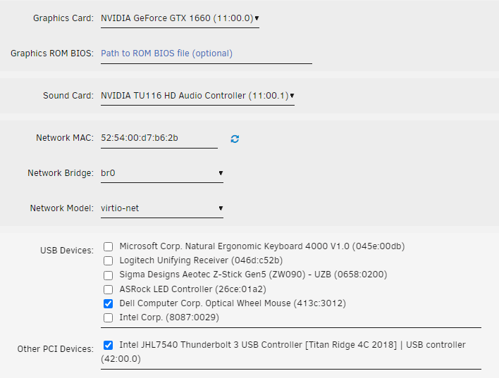

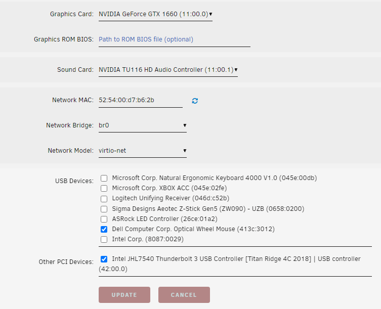

When I start the VM with:
GPU: GTX 1660 (11.00.0)
Sound: TU116 HD Audio Controller (11.00.1)
USB Devices: Dell Computer Optical Mouse (413c:3012 = no issue this is a usb at the back of the PC until I can work out how to do this)
Other PCI Devices:
NVIDIA TU116 USB 3.1 Host Controller (11:00.2)
NVIDIA TU116 USB Type-C UCSI Serial bus controller (11:00.3)
Intel JHL7540 Thunderbolt 3 USB Controller (42:00.0)
Ideally I want the 3 USB ports to be passed through to the VM.  So the VM has plug and play USB.   I get:

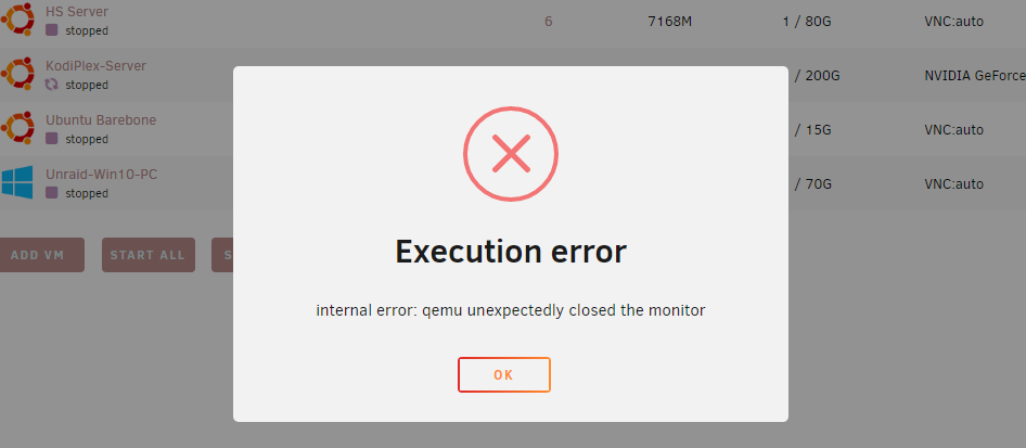

Execution error
internal error: qemu unexpectedly closed the monitor
If I untick all 3 other USB devices - I still get the error
What have I done wrong?

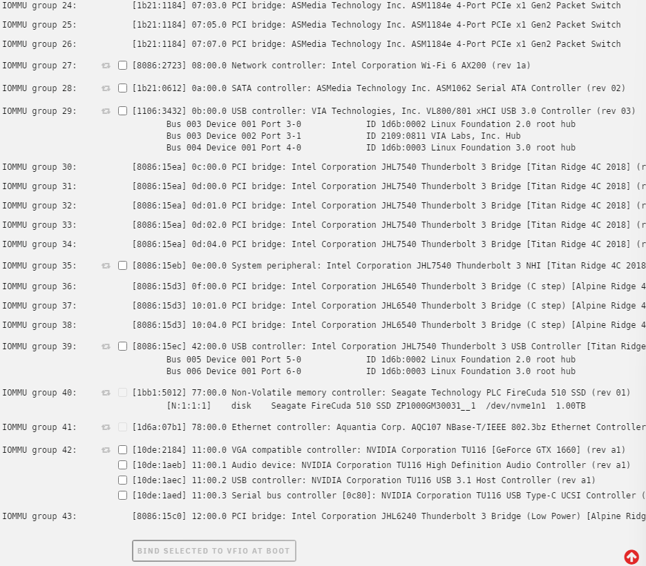

Interestingly the second time I go to run the VM (after unticking all)
have actually disappeared, and I am left with:
 Intel JHL7540 Thunderbolt 3 USB Controller [Titan Ridge 4C 2018] | USB controller (42:00.0) - unticked

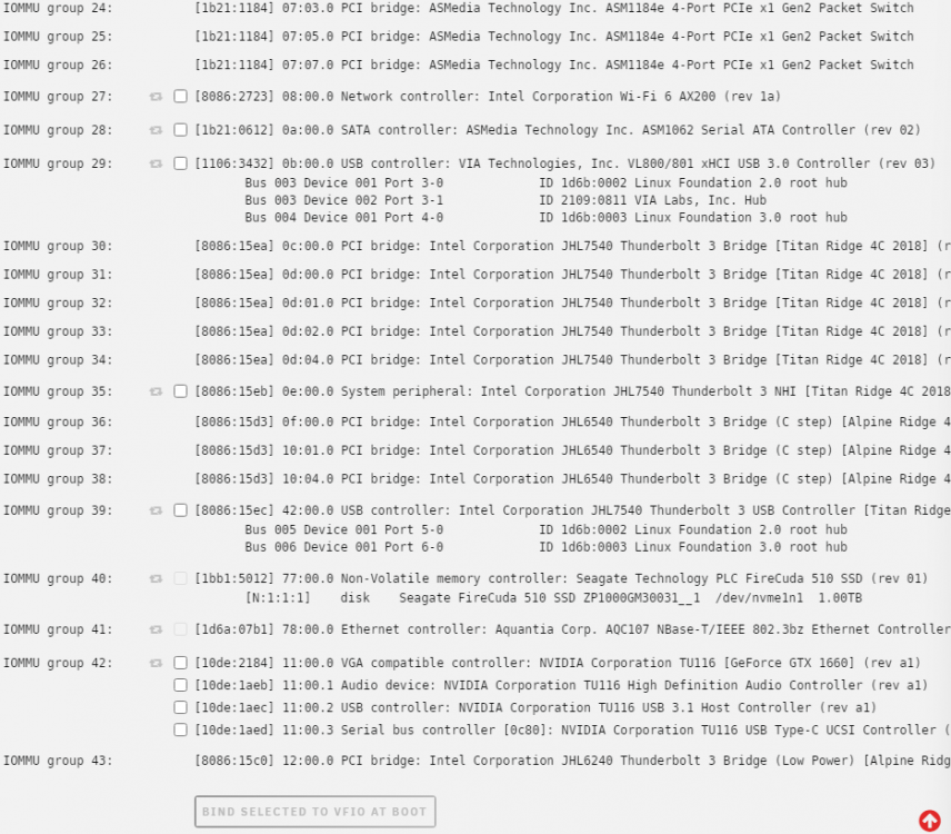

The below is with Both Override and no bindings.
IOMMU group 2:[8086:1905] 00:01.1 PCI bridge: Intel Corporation Xeon E3-1200 v5/E3-1500 v5/6th Gen Core Processor PCIe Controller (x8) (rev 05)
IOMMU group 3:[8086:9bc5] 00:02.0 VGA compatible controller: Intel Corporation CometLake-S GT2 [UHD Graphics 630] (rev 05)
IOMMU group 4:[8086:1911] 00:08.0 System peripheral: Intel Corporation Xeon E3-1200 v5/v6 / E3-1500 v5 / 6th/7th/8th Gen Core Processor Gaussian Mixture Model
IOMMU group 5:[8086:06f9] 00:12.0 Signal processing controller: Intel Corporation Comet Lake PCH Thermal Controller
IOMMU group 6:[8086:06ed] 00:14.0 USB controller: Intel Corporation Comet Lake USB 3.1 xHCI Host Controller
Bus 001 Device 003 Port 1-3 ID 045e:02fe Microsoft Corp. XBOX ACC
IOMMU group 7:[8086:06e0] 00:16.0 Communication controller: Intel Corporation Comet Lake HECI Controller
IOMMU group 8:[8086:06d2] 00:17.0 SATA controller: Intel Corporation Comet Lake SATA AHCI Controller
IOMMU group 9:[8086:06c0] 00:1b.0 PCI bridge: Intel Corporation Comet Lake PCI Express Root Port #17 (rev f0)
IOMMU group 10:[8086:06ac] 00:1b.4 PCI bridge: Intel Corporation Comet Lake PCI Express Root Port #21 (rev f0)

this is unbinded in multi-function:
I will try 31 and 33.
The end goal is to pass through the usb ports..
sure enough:
I will unbind, and see what I get with downstream on.
(earlier I did something where I could see the 2x individual usb 3.1 ports on the egpu)
Edited by SmokeyColes
How it looks with downstream:
I binded just the IOMMU 42 for GPU passthrough.
The VM still has the IOMMU 39 42:00.0 bind shown and ticked, though
I will deselect it from other devices, update.
It has now disappeared from Other Devices.
I run the VM and get:
So that's downstream, multi-mode and both.
I think I will just unbind 42, deselect IOMMU in VM settings and give up passing through the USB controllers (ports) on the back of the egpu.
I would be more than happy to pay someone to get this working if there are any takers?
The USB controllers don't show at all now - they looked exactly like this (taken from someone elses post) asmedia usb
and anything plugged into them no longer work.
Actually I think this whole post may be nonsense; I do not get green circles (only occasionally) and get bind errors.
I think this is related to the fact I have to do pci rescan's.
Does anyone know how to force it reload vfio (except at boot) ?
