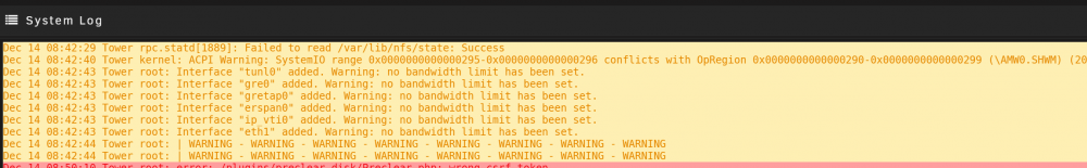

got warning warning warning warning error in the logs. as i was trying to add a 2nd drive to a cache pool
i was trying to add a 2nd drive to my one cache pool a spinner 2tb with my 2tb ssd  as i had it kicking around ant it was full and using my array..

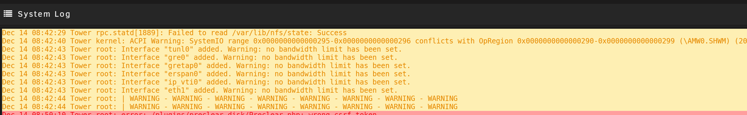

i added it to my lan cache pool   and hit mount    and it was taking longer time to mount  wouldnt mount..  i check the logs..   and i get

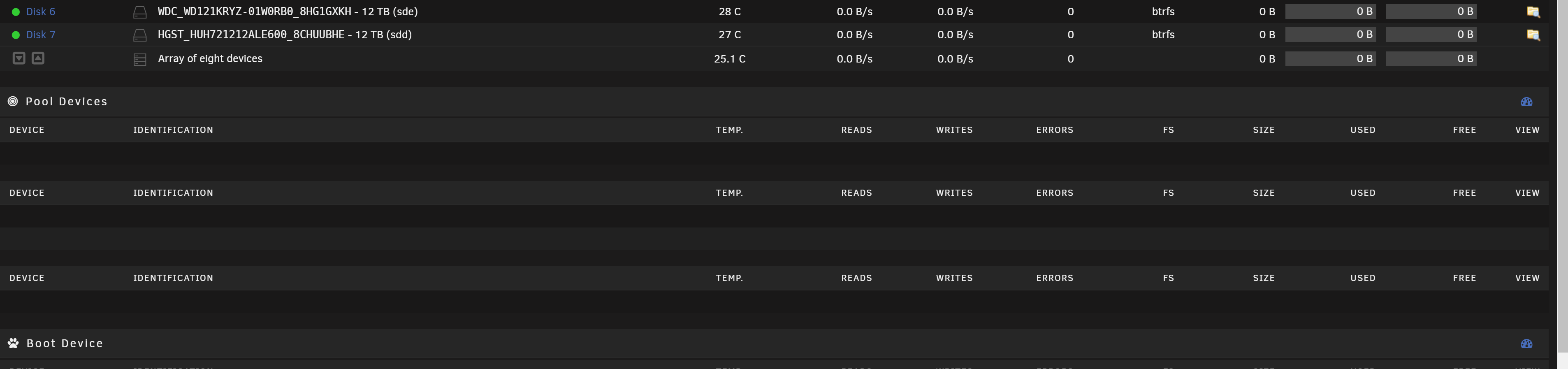

warning warning warning...  doesnt say whats it warning about?    does it say anything?  and my cache pools are blank..
it comes back  if i refresh  5 times or so   but if i got from one page to back to main  its blank
does it say anything going on?

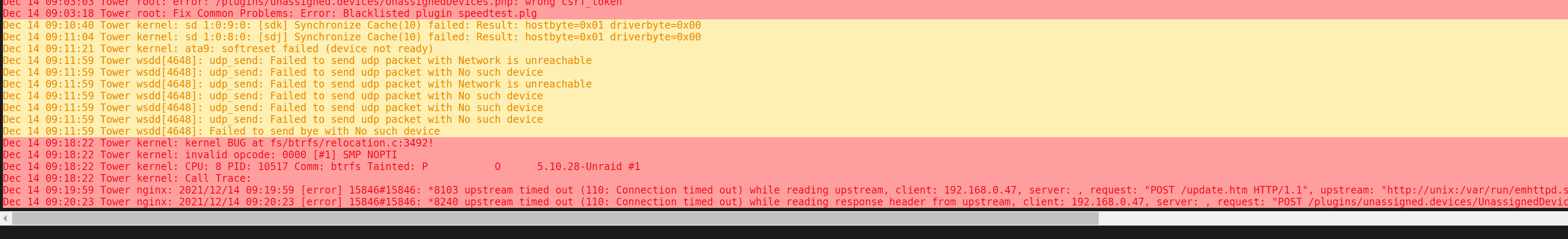

and what is a CPU Tainted Error?
i currently doing a reboot to see if it will mount faster and no errors hopefully
update:   it wont let me reboot.. not even from the terminal   and i type in reboot
seems the system is stuck in endless loop

Btrfs crashed during the initial balance, this suggests there was some existing corruption in that filesystem, best bet is to backup and re-format the pool, some recovery options here if needed, you need to reboot, likely will need to force it, and if the pool crashes on next mount reboot again and try the recovery options before wiping it.

CPU Tainted Error
It's not an error.  Its simply a note the to actual devs of Linux so that they can see if you send them syslogs etc they can tell that it's not a stock linux kernel
