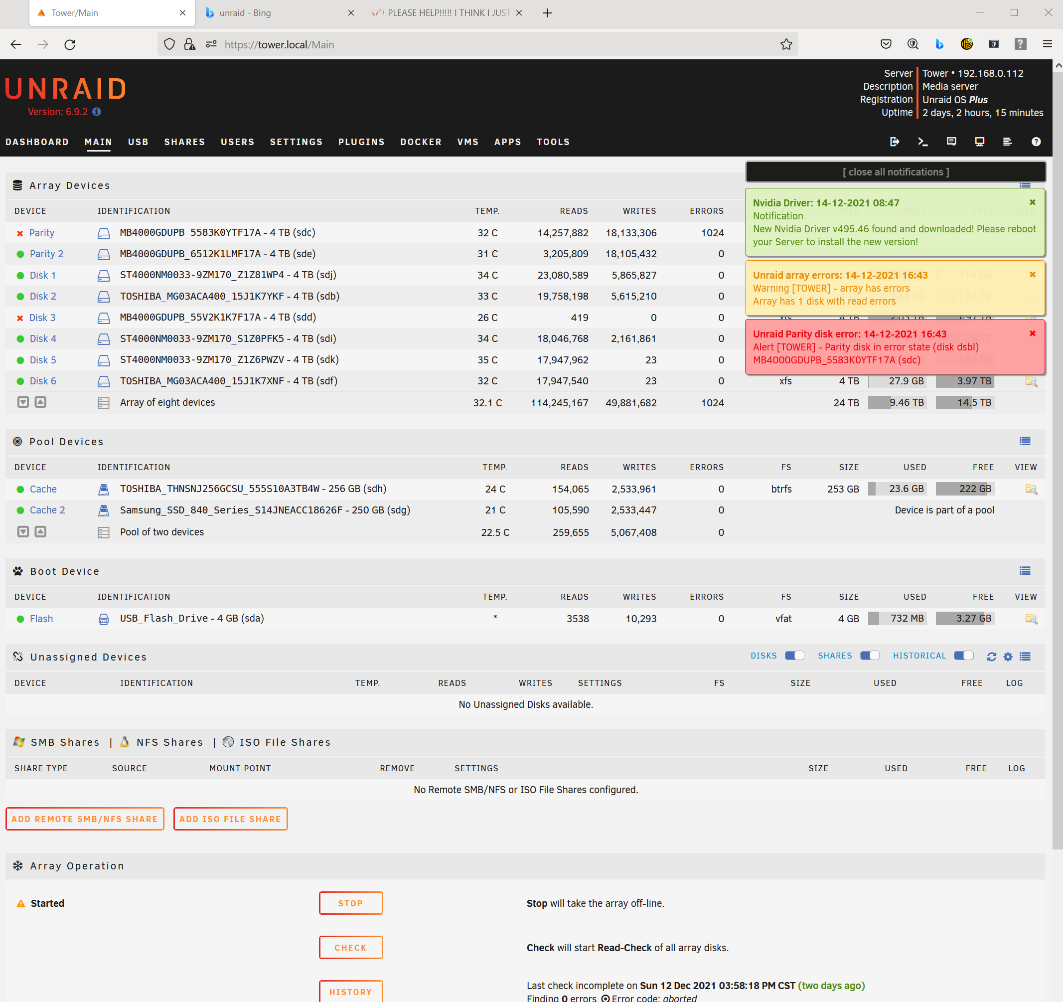

what are the odds it can survive this?
I tend to use refurbishment hardware so problems are expected.  Given the screenshot who thinks replacing these drives with the ones in the mail tomorrow will magically heal it?

Even if parity were good, parity has none of your data. Parity is just an extra bit that allows a missing bit to be calculated from all the other bits. To reliably rebuild every bit of a missing or disabled disk, it must be able to reliably read every bit of parity plus every bit of all other disks. You never want unreliable disks in your server.
attach diagnostics to your NEXT post in this thread.
it sounds like I did not lose any data then.  I will continue my data loading, it is not done yet.  As for reliable, everything is backed up.

Don't know where you got that idea. Certainly not from anything I said.
There are some things about your screenshot that are somewhat ambiguous, such as 2 disks with X when you only have single parity.
That is the reason I asked for diagnostics so I could try to better understand your situation.
Definitely you should not continue to transfer data to the system as it is now.
My mistake, you have dual parity so that clears up the screenshot. But you also have 2 disabled disks, so no parity protection currently, and the disabled disks will have to be rebuilt.
Really you are wasting your time transferring data to this unstable system as it is now. You need to get things working well. Quite possibly it is just bad connections that can be easily fixed, but we can't tell without...

SMART attributes for the disks that were assigned as parity and disk4 don't look good. Looks like they became unassigned disks after disconnecting.
SMART attributes for all other disks looks OK though.
Can't tell whether any disks mount since the diagnostics are with the array stopped.
Not entirely true, syslog shows them mounting the last time the array was started. Even emulated disk4 mounted, so you could conceivably rebuild it though I would replace it for rebuild.

My update of what happened.  I installed the SAS (was SATA) hard drive controller and booted it up with the drives pulled I deemed bad (3x) removed by SN from the identification screen in unRAID.  Installed the three new drives and it came up with the error that I had too many drives out of place.  So I went over to  tools new config and clicked it.  Rebooted for good measure and the screen showed me all the normal data is about to get destroyed alerts.  I said yup, go ahead and getter done.  It came up right away with 70% of my data present, all of it was unprotected, and Parity-Sync and rebuild was afoot for the damaged contents.
That is exactly what I expected to occur and was well within my parameters for this server.  That and my write speeds are now double what they were.  One day to built Parity is now 6 hours.  Two more drives started showing warnings ... so, back to Amazon.  I am wondering if maybe this time I go with low end desktop new drives....  I think they would have more life in them time/cost ...
