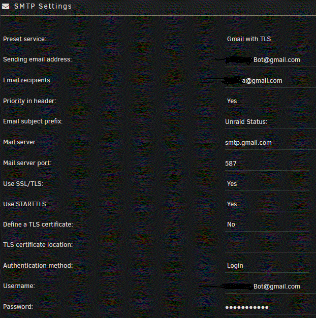

Here is a snip from my SMTP settings.  The email was sent to the Sending email address/SMTP account, rather than the Email Recipient.
All other Unraid emails have gone to the Email Recipient account.  Hope this helps. Thanks

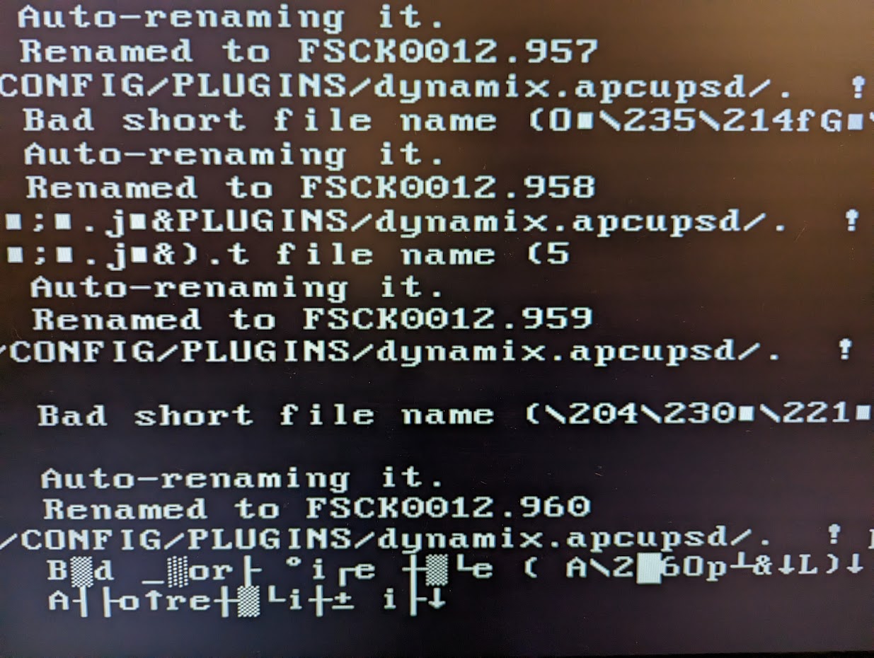

1 hour ago, Phrendo said:
It never returned, no ping and the box is just beeping randomly now for 10 minutes.
Attach a monitor and see what's on the local console.
See the attached, it seems to be cycling through FSCK.  Right now its at FSCK0013.204.  It's still beeps every once in a while, but not as often as when it started.
