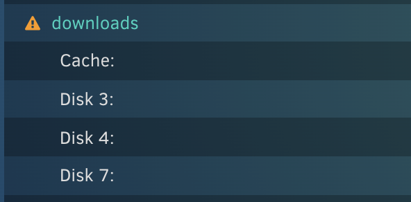

** I even moved files out of cache and got it to be green as it should be, but as soon I download something it gets copied to the cache pool.

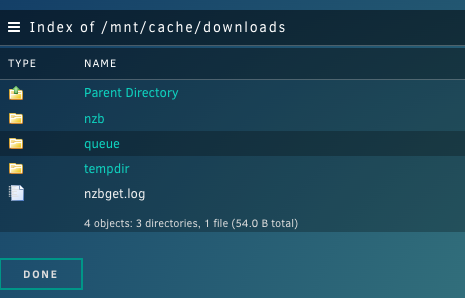

I deleted everything in downloads and started the containers one at the time, seems like upon starting nzbget writes in cache

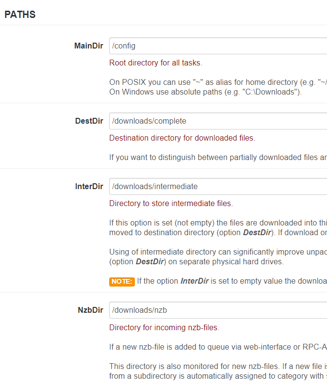

It's worth checking the Path settings within NZBGet. The main path is /config as default ...
Edited by hawihoney
path on both is /mnt/user/downloads
I agree it looks like it should work :(

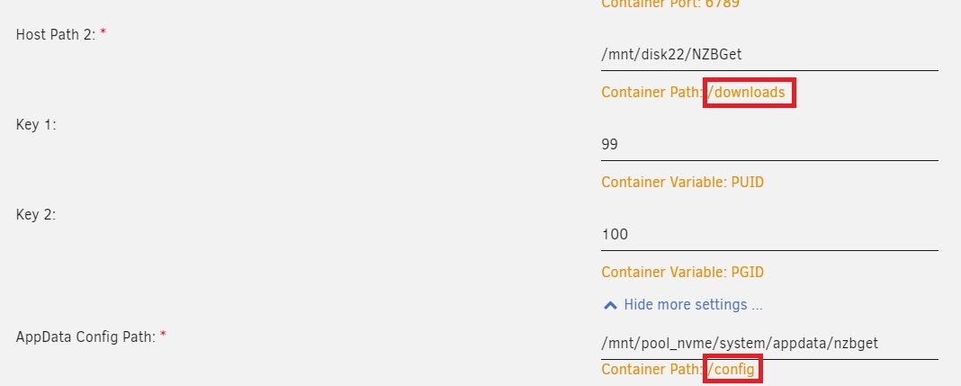

These are my settings for NZBGet. Perhaps this helps. Docker:
You could try changing the mapping to use /mnt/docker/downloads instead of /mnt/user/downloads so it is by-passing the User Share handling level?
this might be my only option at this point, another option is to wipe nzbget and qbit, remove the download share as well and start fresh, something is stuck.
looks like you are forcing it to go to disk22 where I have it as /mnt/user/downloads which is picking the wrong disk at the end.
