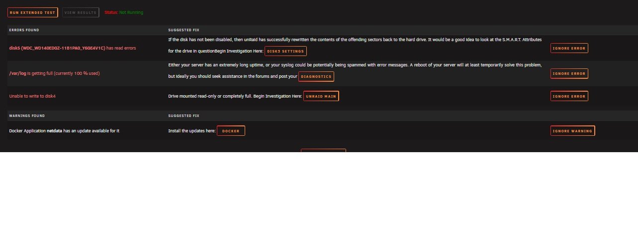

So I recently added a wd purple to unassigned devices to run with some cctv recently purchased . It added fine.

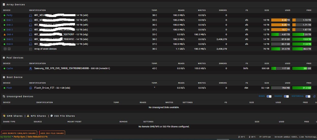

Shortly after I started getting messages that disk 4 (in array) was disabled and emulated. And also noticed my wd purple is now under historical devices not unassigned.

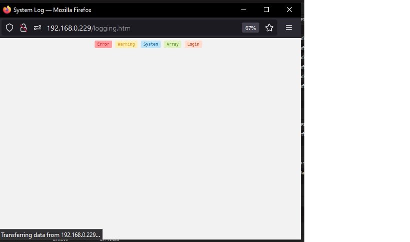

I thought I could stop array, unassign disk 4, start array, stop array re assign and start and let it rebuild. That didnt seem to work for me. i I now not only get that disk 4 is disabled but disk 5 is throwing tonsss and i mean tons of errors.  I cannot access the log via webui. I had a syslog setup in one of my shares and i dont even see it anymore.  Kinda lost on where to start. i've attached what i could think of . let me know if i can provide more. Thanks.

SMART attributes for disks 4, 5 look OK. Not clear this is a connection problem though. Have you done memtest recently?

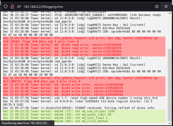

Syslog ran out of space due to all the I/O errors logged on disk5. Don't see SMART for any unassigned disk, is it connected?
Good news is all disks mountable, including emulated disk4.
Might as well cancel rebuild for now. Then disable spindown on disks 4, 5 and run an extended self test on each.
