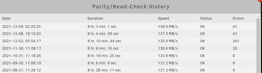

I have ran parity 3-4 times now, ran smart reports on drives if any are bad. Nothing.
The only thing that is left is memory, bad sata cable. I have ran mem test before, nothing came up (didnt do it atm yet no time). Checked sata/power connections all good.
Running parity, which states there are 41 errors, to fix those problems. Yet after running parity and yes i checked the "write corrections to parity" option, but after it finishes it states 41 sync errors.
Im lost. I am about to do a parity swap & a data drive swap and I am waiting only bcs of these errors floating around!
Anyone knows what the issue is for sync errors not getting corrected?

Log only shows one check, maybe the other one was non correcting, run another non correcting check and post new diags if it still finds sync errors.
I had to reboot the server when adding new disks, maybe that is why?
Log starts over after every reboot, so no way of knowing now if the previous check was correcting or not.

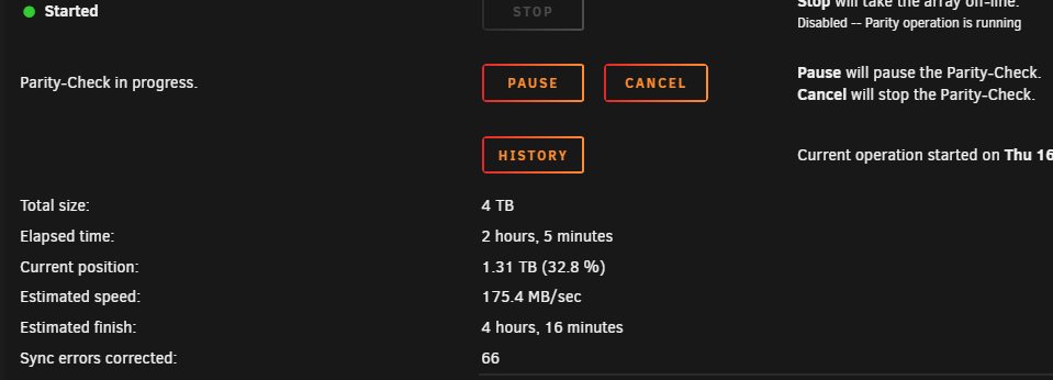

Weirdly it has corrected 66 errors currently! Not sure why it is finding more errors than the previous parity check.

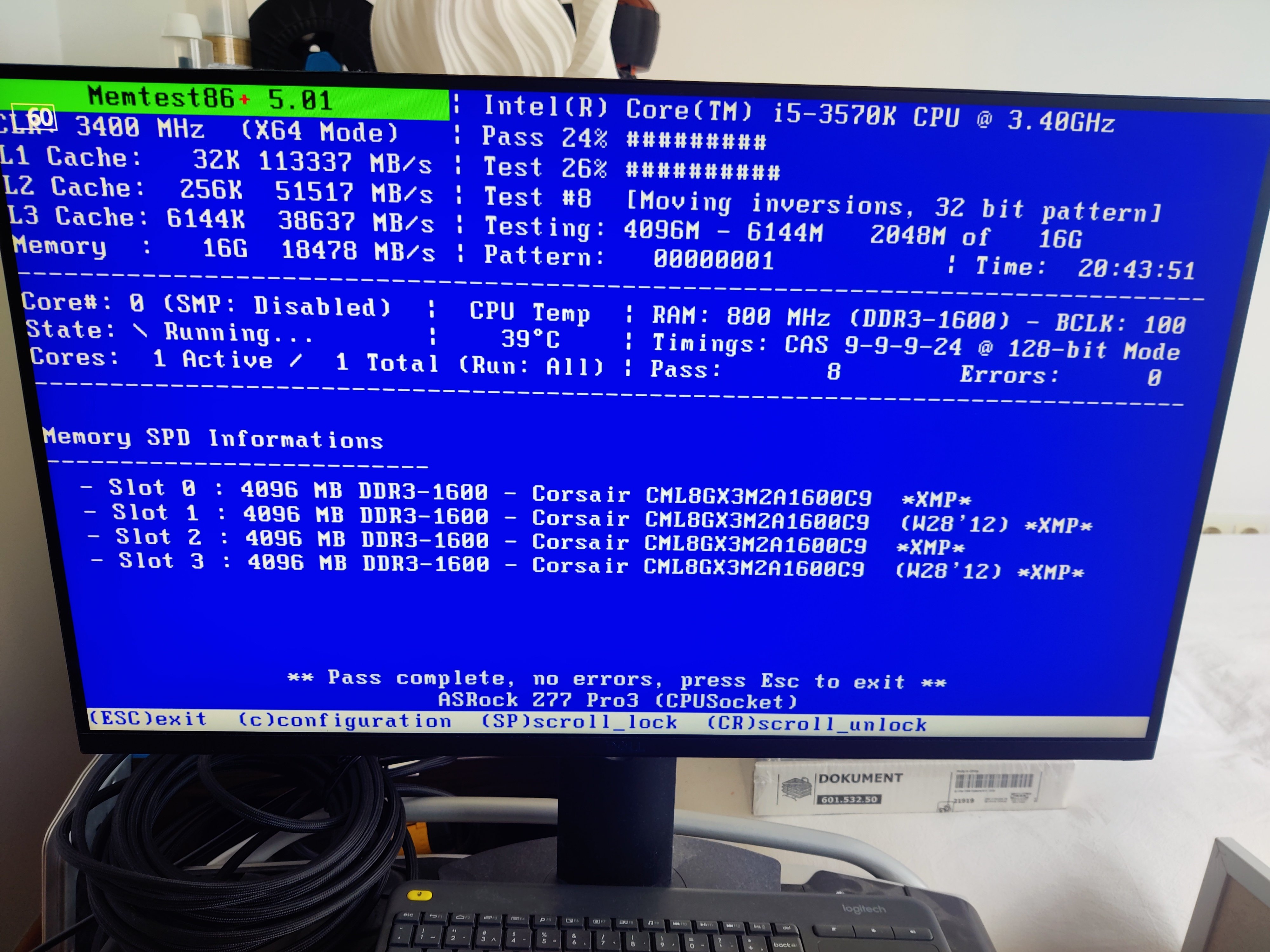

That suggests a hardware issue, start by running memtest.
Just a FYI - if you install the Parity Check Tuning plugin than (even if you do not use its pause/resume features) the Parity History entries will include extra information such as what type of check was run.
Running it now. So far so good. I will keep it running till i get back from work. Will update then!

I am currently tho trying to remove plugins as I am having complete freezes while in normal mode, and can only do parity in Safe mode safely as it does not cause crashes. I am assuming one of the plugins is messing with stability, im assuming not a hardware issue (maybe ram) since it does i nicely in Safe mode.
I left memory running all night. Seems like there are no errors.
If it's not RAM the next suspects are a controller or a disk, since you're using controller with SATA port multipliers and those are not recommended anyway I would start by replacing that.
