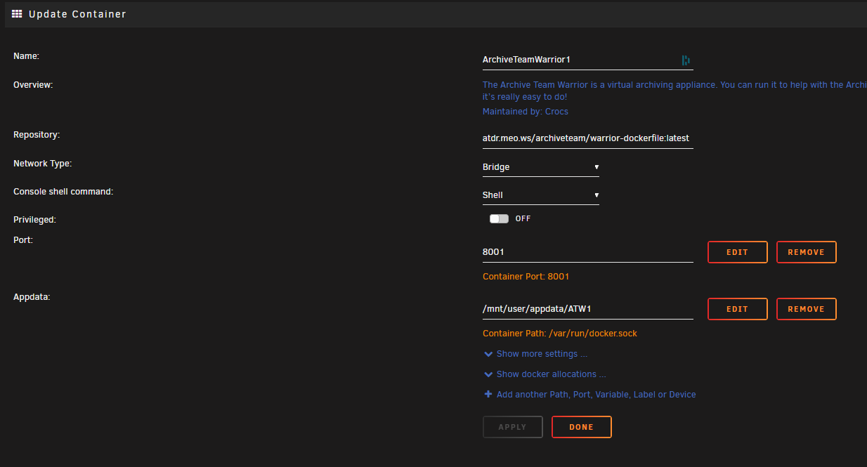

January 1, 20224 yr I think the unraid template is wrong: The path which is called Appdata and contains a placeholder appdata path is actually being mounted to the docker.sock file. I doubt that this is intentional:
January 1, 20224 yr 1 hour ago, SourceDiver42 said: I think the unraid template is wrong: The path which is called Appdata and contains a placeholder appdata path is actually being mounted to the docker.sock file. I doubt that this is intentional: Yup. Obviously wrong
February 27, 20224 yr I setup this path after examining in the console for a minute. Seems to be working to save projects/data outside the docker image. Disclaimer, I've been running this merely for a few minutes only so far. I did leave the docker.sock mount as defined. Edited February 27, 20224 yr by GoChris
March 22, 20224 yr Author On 2/27/2022 at 11:42 AM, GoChris said: I setup this path after examining in the console for a minute. Seems to be working to save projects/data outside the docker image. Disclaimer, I've been running this merely for a few minutes only so far. I did leave the docker.sock mount as defined. That's pretty much how I have the updated template. I used '/mnt/user/appdata/warrior/' to map it to the appdata share vs directly to to cache drive.
April 14, 20224 yr I am having an issue where every time the docker container is updated, it loses the config. So I have to keep entering a nickname and choosing a project. Here is my config (I have 5 instances of warriors and each warrior is mapped to its own appdata folder.
