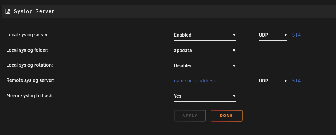

ok it crashed last night. i had enabled the syslog data capture before the tower-diagnostics-20211223-1056.zipcrash. Is this what you need or do i need to grab logs from somewhere else?
the crash was around 11pm pst last night
Yes, from where you chose to save them in the syslog server.
i told it to mirror locally in appdata, but i don't see a folder for logs so where do i grab them from?
syslogoh maybe this?
Nothing obvious logged, some strange SMB related errors, pool detected some corruption, which suggest possible RAM issues, crashes are likely hardware related.
