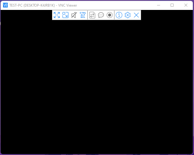

And in realvnc the screen is just black.
Hdmi output says "no input" and realvnc is just black.

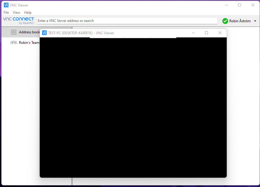

I get No errors what so ever in the log, but screen output is zero and realvnc is just black.
Going back to VNC as a gpu and its back to working.

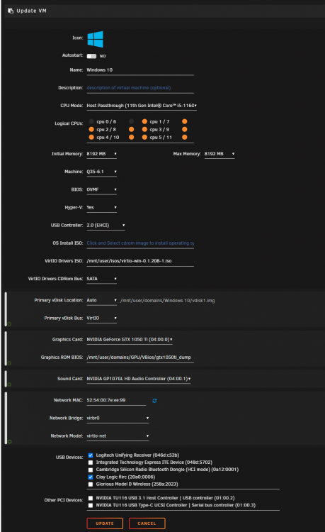

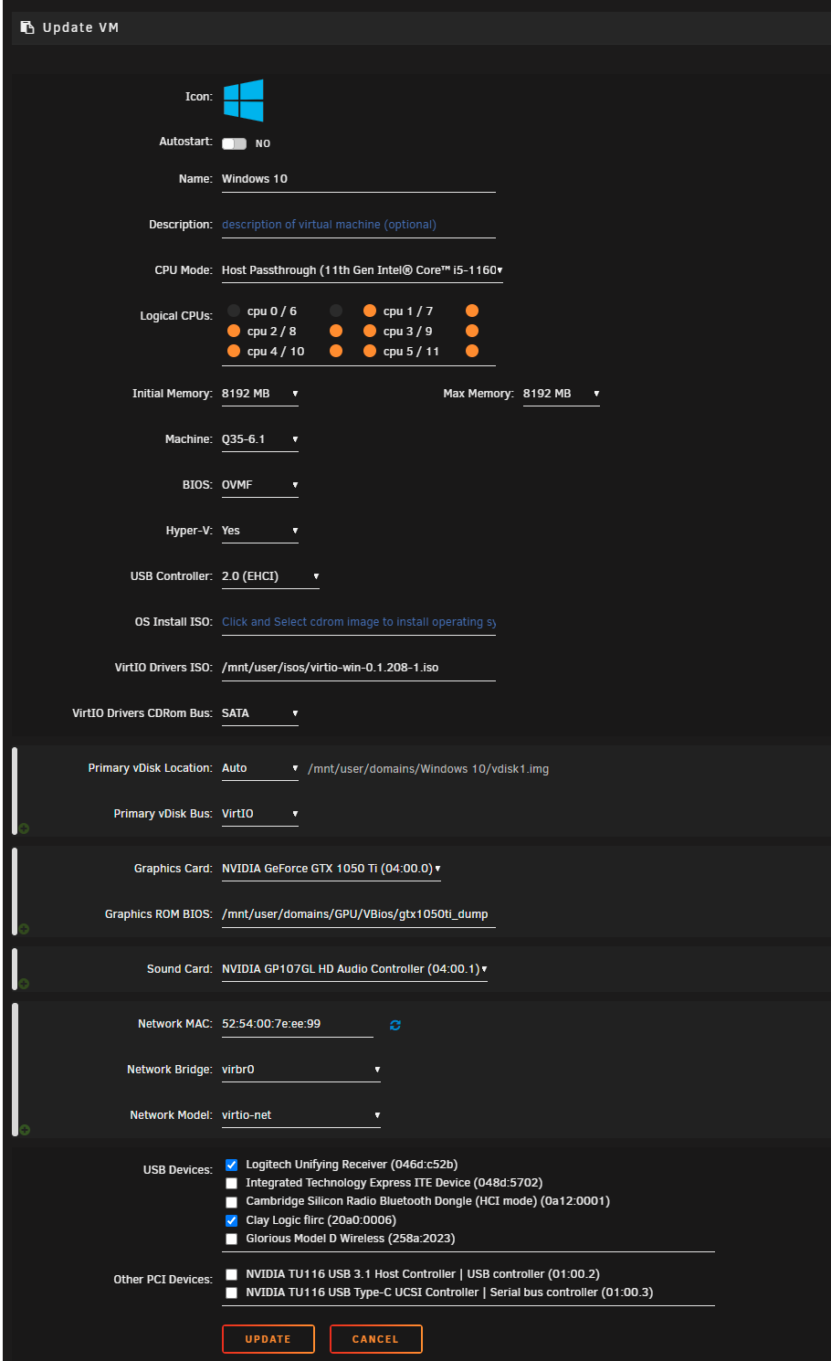

The vm i´m trying to get working right now is just a random W10 vm, since it uses the same config as the android tv one, just a different os (that supports realvnc) i figured it would be easiest to try get working.
The one thing I´ve just now noticed, is this :
"-display none \
-no-user-config \
-nodefaults \"
My working VM does not have those lines in the log.
Diag and everything is in this post.
belk-diagnostics-20211223-2227.zip NOT WORKING VM log.txt vfio log.txt WORKING VM log.txt
