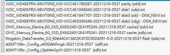

Dec 18 01:20:34 PinFish kernel: blk_update_request: I/O error, dev sdf, sector 520 op 0x0:(READ) flags 0x80700 phys_seg 31 prio class 0
sdi sdg sdf sdh come from enclosure, quite weird have ASMT109x device there .... I expect you can't use the enclosure, pls also try update enclosure firmware as mention in previous post.
