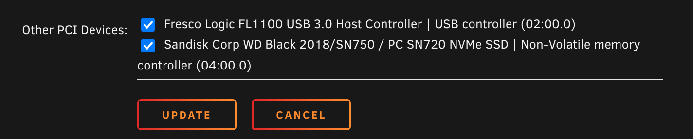

6 hours ago, BenjaminMetzler said:
vfio_err_notifier_handler(0000:04:00.0)
      <driver name='vfio'/>
      <source>
        <address domain='0x0000' bus='0x04' slot='0x00' function='0x0'/>
      </source>
      <address type='pci' domain='0x0000' bus='0x06' slot='0x00' function='0x0'/>
    </hostdev>
What is this?
I believe this is the GTX1050TI graphics card that I am trying to get working.
it isn't, gpu is at 01:00.x.
My mistake.  It could be the NVMe drive.   Here's what I am passing through, which works when I don't pass through the graphics card.
Edited by BenjaminMetzler
Attach your diagnostics file.
It's the nvme, I read that sometimes nvme+gpu don't play well in some builds.
You can also try to passthrough the gpu (multifunction device) and not passthrough the nvme controller, but nvme disk attached to a virtual sata controller, something like this:
    <disk type='block' device='disk'>
      <source dev='/dev/disk/by-id/DISKID'/>
      <target dev='hdd' bus='sata'/>
      <address type='drive' controller='0' bus='0' target='0' unit='3'/>
    </disk>
Replace DISKID with yours, navigate to /dev/disk/by-id/  , print the content of that directory and find your id.
Thanks.  I switched from using an NVMe to an SSD using the by-id method and that was able to boot the VM.  The 1050ti isn't seen by Windows though.  Device manager doesn't even show a display device (or sound).  I've tried multiple vbios as well as without and the 1050ti isn't seen.  Below is my latest XML if you all have any  thoughts.

    <controller type='pci' index='2' model='pcie-root-port'>
      <model name='pcie-root-port'/>
      <target chassis='2' port='0xa'/>
      <address type='pci' domain='0x0000' bus='0x00' slot='0x01' function='0x2'/>
    </controller>
    <controller type='pci' index='3' model='pcie-root-port'>
      <target chassis='3' port='0x12'/>
      <address type='pci' domain='0x0000' bus='0x00' slot='0x02' function='0x2'/>
    </controller>
    <controller type='pci' index='4' model='pcie-root-port'>
      <target chassis='4' port='0x13'/>
      <address type='pci' domain='0x0000' bus='0x00' slot='0x02' function='0x3'/>
    </controller>
    <controller type='pci' index='5' model='pcie-root-port'>
      <target chassis='5' port='0x8'/>
      <address type='pci' domain='0x0000' bus='0x00' slot='0x01' function='0x0' multifunction='on'/>
    </controller>
      <address type='pci' domain='0x0000' bus='0x02' slot='0x00' function='0x0'/>
    </controller>
      <address type='pci' domain='0x0000' bus='0x00' slot='0x1f' function='0x2'/>
    </controller>
    </controller>
      <master startport='0'/>
    </controller>
      <master startport='2'/>
    </controller>
      <master startport='4'/>
    </controller>
    <interface type='bridge'>
      <mac address='52:54:00:99:b8:39'/>
      <source bridge='br0'/>
      <model type='virtio-net'/>
      <address type='pci' domain='0x0000' bus='0x01' slot='0x00' function='0x0'/>
    </interface>
    <serial type='pty'>
        <model name='isa-serial'/>
      </target>
    </serial>
    <console type='pty'>
    </console>
    <channel type='unix'>
    </channel>
    </input>
      <source>
        <address domain='0x0000' bus='0x07' slot='0x00' function='0x0'/>
      </source>
      <address type='pci' domain='0x0000' bus='0x03' slot='0x00' function='0x0' multifunction='on'/>
    </hostdev>
      <source>
        <address domain='0x0000' bus='0x07' slot='0x00' function='0x1'/>
      </source>
      <address type='pci' domain='0x0000' bus='0x04' slot='0x00' function='0x1'/>
    </hostdev>
      <source>
        <address domain='0x0000' bus='0x02' slot='0x00' function='0x0'/>
      </source>
      <address type='pci' domain='0x0000' bus='0x05' slot='0x00' function='0x0'/>
    </hostdev>
    <memballoon model='none'/>
  </devices>
</domain>
Audio bus is wrong, check it.
Thanks.  Fixing the audio bus allowed it to be seen by the OS.  Now I'm getting error 49 for the graphics card, but I think I can debug that issue.
Ben
