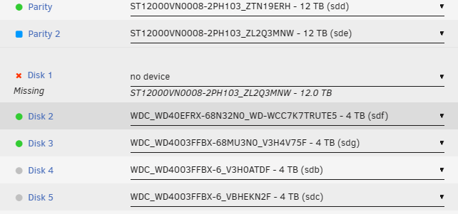

August 1, 20233 yr Did New config, ran that, stopped the array, moved the Disk 1 to Parity Drive, but now showing this:
August 1, 20233 yr Community Expert Looks like you may have done something wrong with the New Config - did you hit the Apply button? You should have been able to switch the disk1 to the parity slot immediately after you ran New Config.
August 1, 20233 yr Community Expert New config wasn't done correctly, like mentioned make sure you click apply.
August 1, 20233 yr Yeah... probably would be smart to use the correct Tool.. I was using Docker Safe New Permissions - had that in my head for something else I was working on. Trying correct tool now.
August 1, 20233 yr I need to ensure I select all once I move Disk 1 to Parity... and on the New Config Tool, "Preserve current assignments" I should likely select All?
August 1, 20233 yr Thank you all.... Parity Sync in progress. looks like all my dat is on the other disks. Appreciate you!
