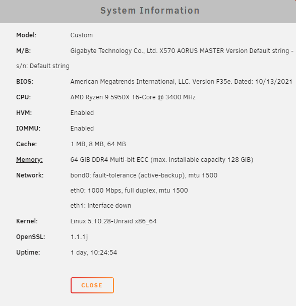

My Hardware specs :

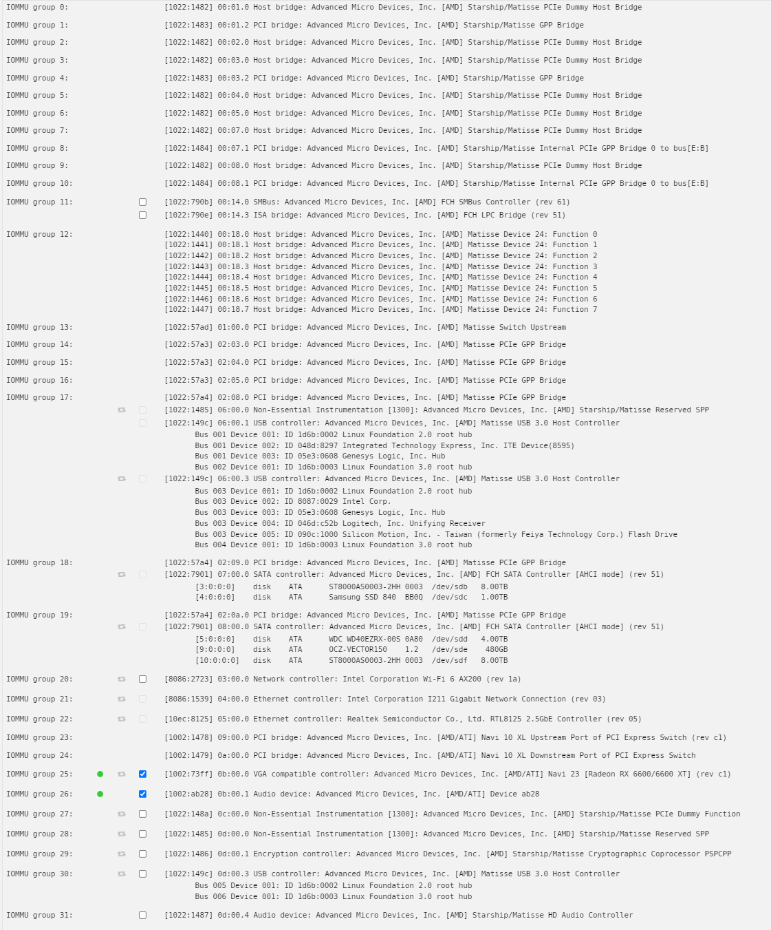

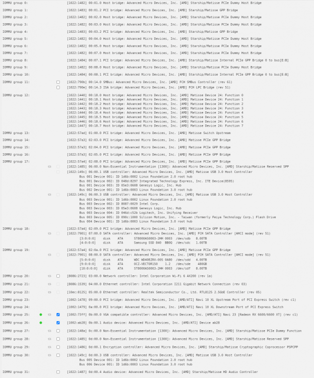

System devices:

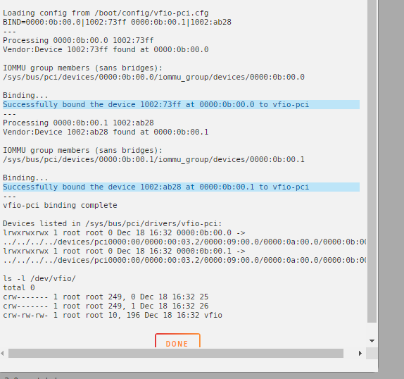

VFIO-PCI Log:

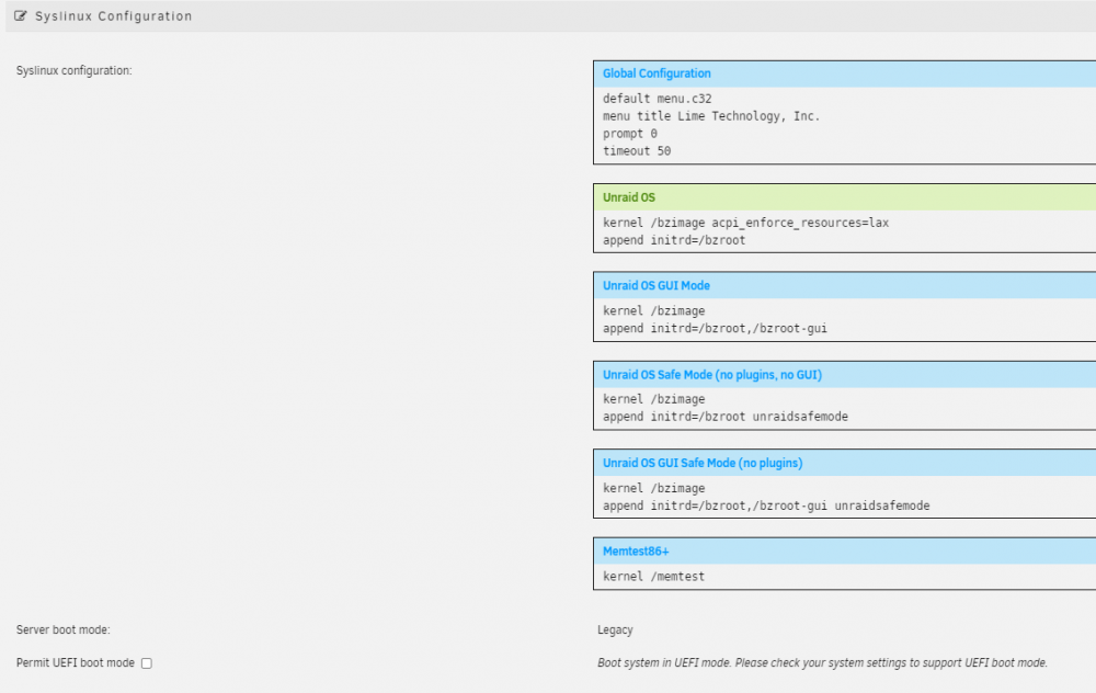

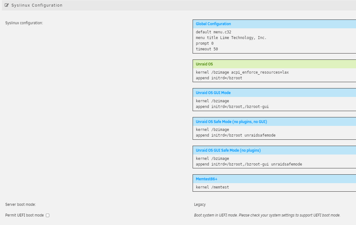

Syslinux config:

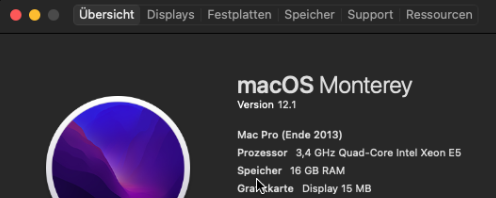

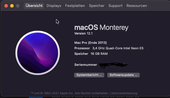

And please double check again you are reading 12.1 in about this mac, not 12.0.1, nor anything else.

Is the gpu a reference amd card?What are vendor/product ids?
I don't know what a reference amd card means, but i have a MSI RADEON 6600XT MECH 2X.
A reference card is that produced and ideally sold by amd.
Non reference cards are that like msi, sapphire, asus, etc.
When apple says that a gpu is compatible with its os it means that the reference card is compatible, non reference cards may have bios mods, even different product ids, making them more difficult to be compatible or not compatible at all.
Make sure you use the latest version of lilu and whatevergreen, you may need also agdpmod=pikera boot-args; if it doesn't work search for the product id of your card, if different you may spoof it to a compatible one.

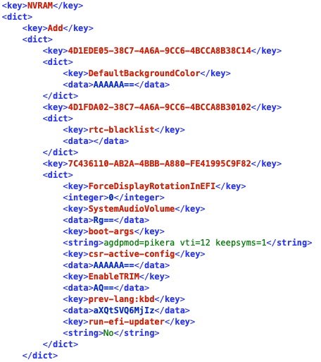

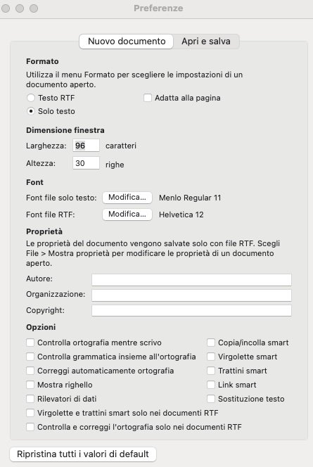

Set textedit like this, important are "only text" and no checks:
Navigate to /EFI/OC and open config.plist with textedit.
Find boot-args and add agdpmod=pikera, as an example:
Save config.plist, close it, unmount the efi partition and reboot mac os.

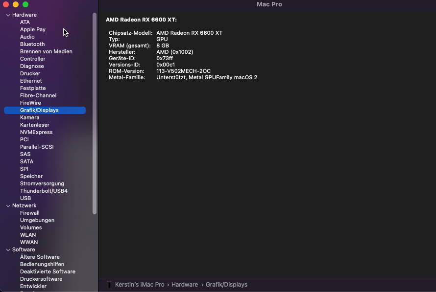

One step back, what is happening with gpu passthrough only?
When using vnc (unraid vnc) enable remote access inside mac os, then switch to gpu passthrough, because if you get a black screen, but you are able to access mac os via vnc enabled inside mac os (not that of unraid), it could be an issue with gpu initialization only, and that boot-arg may solve the issue.
Edited by ghost82
It boots but i think the grafic card is not shown on mac.
With gpu passthrough only:
Post a screenshot of About this mac -> System report -> Graphics/Displays
Download ioregistry explorer, open it, file -> save as... and attach it here.

ok, your 6600 xt seems compatible and it's recognized correctly, both video and audio.
Did you apply the agdpmod=pikera boot-arg in config.plist?
You have no "display0" attached to the gpu, and this sounds no port or incorrect port initialization.
agdpmod=pikera should do the initialization, if it doesn't work try also to change the video port.
With my 6900 xt without whatevergreen the hdmi port works, but only 1 dp port out of 3 works.
With whatevergreen + agdpmod=pikera hdmi and all dp ports work.
No.
I am connected actually with hdmi.
you need to add agdpmod=pikera as explained:
Currently you have this:
So replace in config.plist this:
<key>boot-args</key>
<string>-v keepsyms=1</string>
With this:
<string>agdpmod=pikera -v keepsyms=1</string>

I am thinking to change the grafic card to the Primary PCIEXPRESS slot....
I am now in the secondary and nothing in the primary.
I wanted to buy a more powerful grafic card in the future.
Do you think this can have any effect?
You need to make sure the gpu is not in use by the host, bounding it to vfio and check that unraid is not using it with vesafb if booted in uefi mode.
