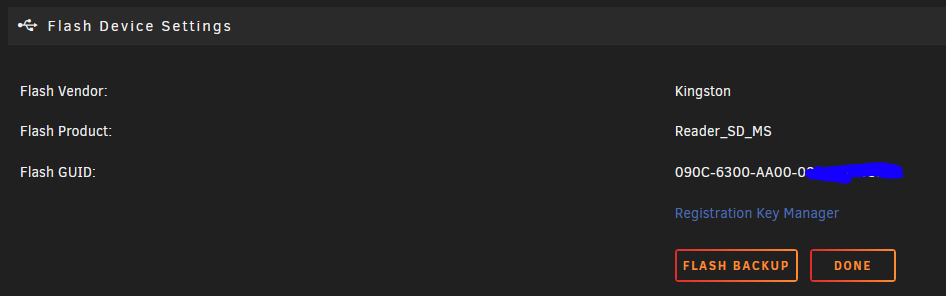

Does it have a Unique Identifier ?
Did you transfer the licence to another flashdrive ?
It has a unique identifier:
And this server was installed last weekend, so the registration is valid with this stick.
I didn't transfered it to a new stick.
As i said on the current stable version this stick runs fine.
Only if i update to the latest version in the Next train, this stick will be blocklisted.
