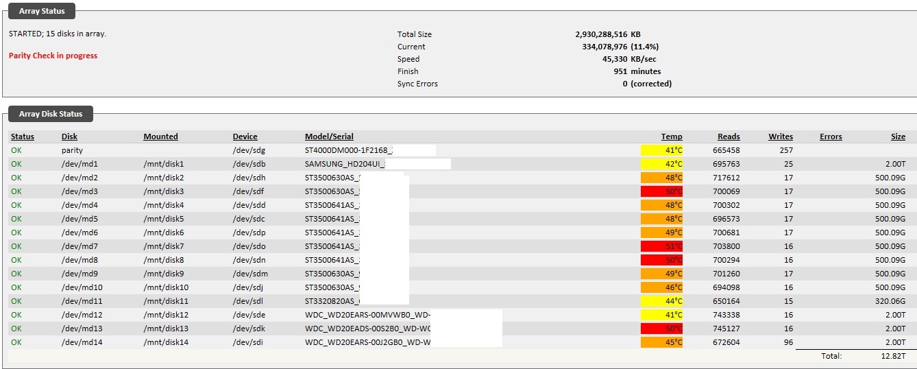

So I bought the SilenX Effizio from Germany (not sold in the UK) and now the server runs, about 10 degrees hotter than before.
The fans are much quieter than the stock ones, and they do get noisier as parity calculates, so I guess the Thermistor does work (they didn't spin for a few minutes until temperature was higher than the minimum level)
I have setup parity and let it go on for an hour, temperatures reported are in the pic below
I don't like to see red, and I do wonder if 50 is above what I can accept...
Shall I send them back or can I live with 50 C?
