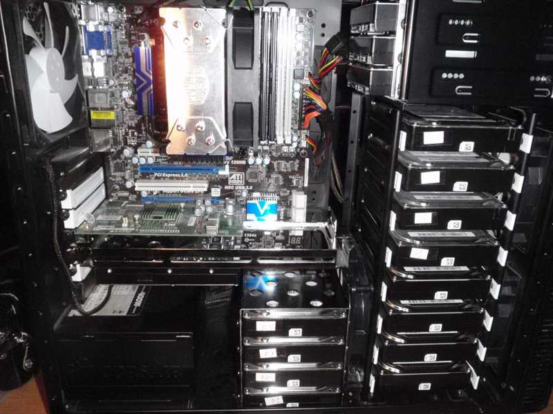

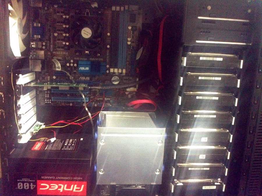

20 drives in a CM Stacker 810.. but if you do some kind of rigging, you can fit about 3-4 drives internally on the floor of the case.
I bet something like this could fit in the bottom of the case if nothing blocked the the hieght.. i.e. empty motherboard slots at the bottom.
http://www.amazon.com/Sans-Digital-HDDRACK5-5-Bay-Organizing/dp/B001LF40KE
or even
http://www.newegg.com/Product/Product.aspx?Item=N82E16817993002
If have done this for test in a fractal disign R3 and works nice when i will need to:)

another nice build with 16 drives (not mine) doesnt worth the extra cost since i could buy a rebel12,but nice though(end of offtopic)
