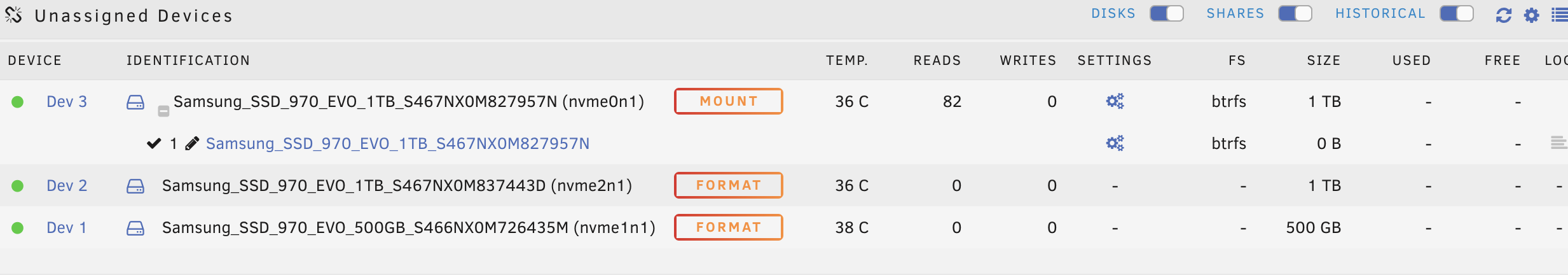

Then I restarted my whole unraid system and now it is showing up in unassigned devices. Hoping it can be remounted or salvaged somehow. I have diagnostics here. I screenshotted how it appears. It's the dev3 device.
any help would be great. thank you

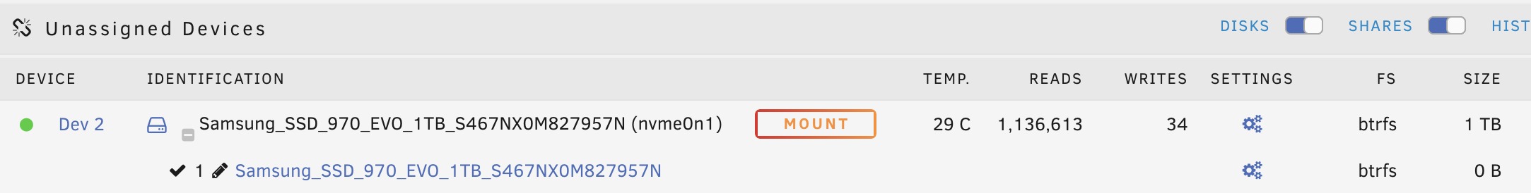

when i stop the array to re-assign it this is how it appears in unassigned devices657632507_ScreenShot2021-12-23at9_05_41AM.thumb.png.fd2c9eb0db243d900833bdeaa0c29e4c.png

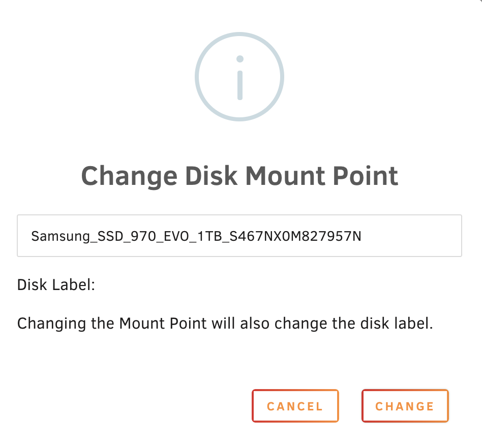

if i click that blue disk name i get this
182509729_ScreenShot2021-12-23at9_06_08AM.thumb.png.f9e6e87aa808ba36e8c7059f5c06739b.png

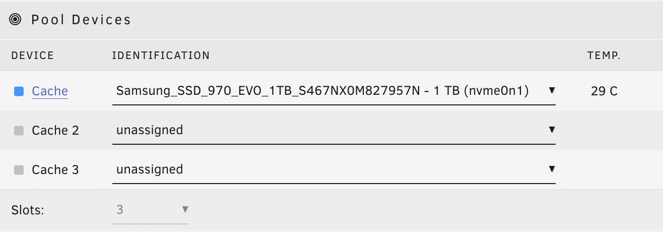

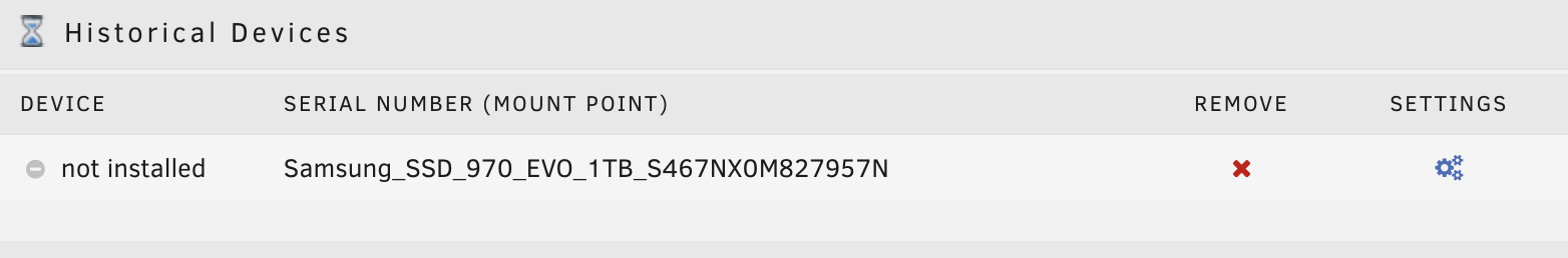

when i assign it to the cache pool, this historical devices shows up
2038706667_ScreenShot2021-12-23at9_07_53AM.thumb.png.f278a572309d691abe88aa4039d3b69a.png
is this something i need to be worried about before starting the array with the disk put back in the cache pool (formatting or anything like that?)
do I need to change the disk mount point first? or do I just assign the disk?

On 12/23/2021 at 9:28 AM, JorgeB said:
Pool is showing 3 slots, if there was just one assigned it's still OK, but make sure you've started the array once before without any device assigned, there can't be a "all data on this device will be deleted" warning for the pool device.

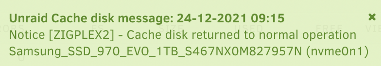

I stopped the array and the cache disappeared again, but on a full shutdown and then starting back up it re-appeared and i got this
it auto-mounted and was correctly assigned again. this is super confusing. when i had the issue from the previous post the 'missing devices' warning happened overnight with the machine running. no restart or shutdown. diagnostics from this boot included.
