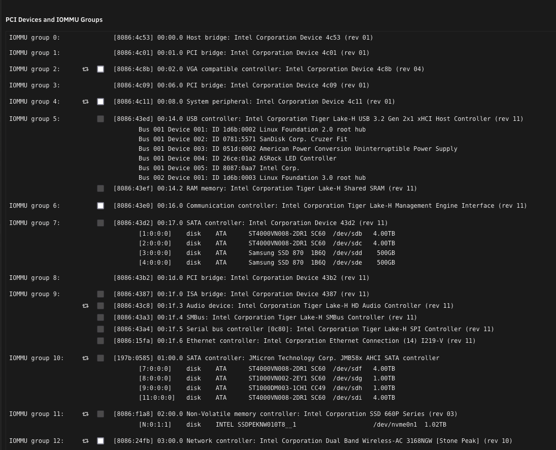

Hi @ghost82 and @morethanenough I'm getting a similar error but not exactly sure I understand this solution or if it will work for my case.
I’m running and intel i5-11400 with iGPU. No other GPU. Attached is what my system devices looks like.
I have tried all the options for ACS override before but it made no difference in the system devices.
According to my screenshot, what do I need to do?
Thanks
Thanks

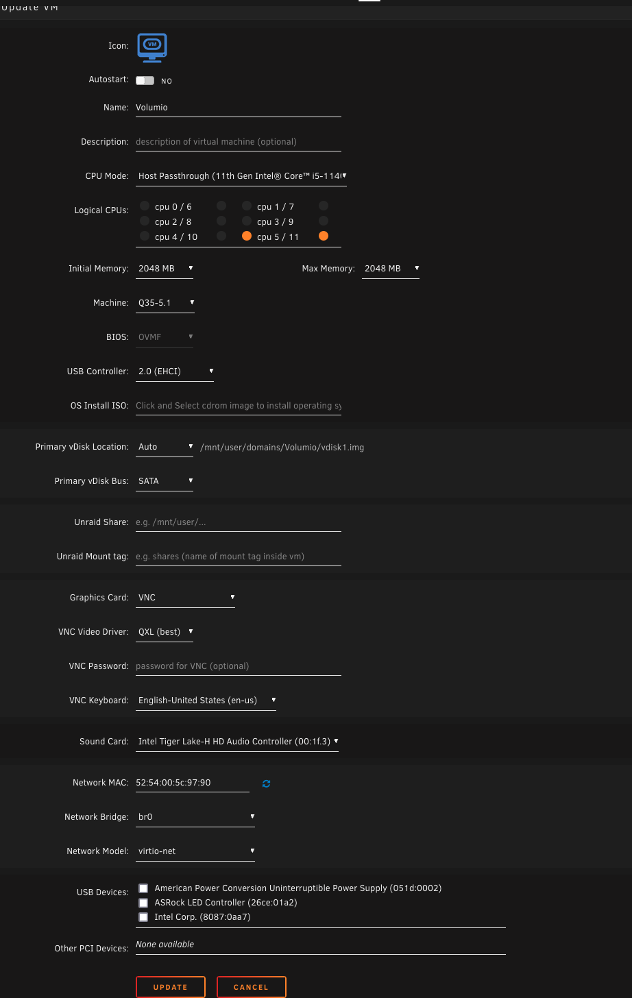

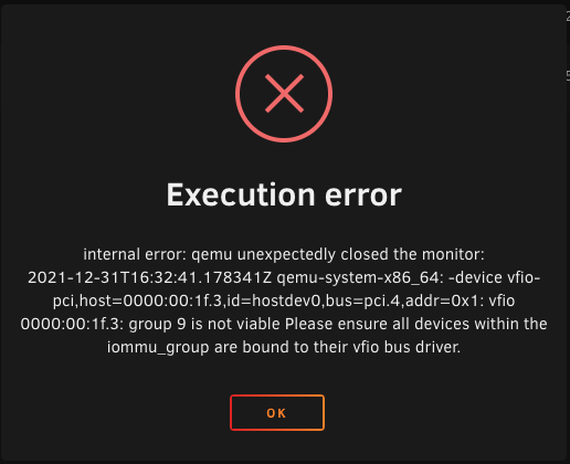

Can you show us a screenshot of the error you are receiving and please attach your system diagnostics.
17 hours ago, TekDRu said:
attached is the screenshot of the vm settings, error and my system diagnostics.
Hi, try to enable acs override (try with 'both' option), reboot unraid, and see if the actual iommu group 9 splits.
Unfortunately I don't think it could be splitted, but I can be wrong..
I tried it again using the 'both' option as well as 'vfio allow unsafe interrupts' set to 'Yes'  but nothing changed.  I see that FLR icon is next to the audio device.  What does that do and can it help?  If not, what other options do I have with my setup, in order to be able to use volumio (even if I use snapcast server to send audio out to other Raspberry Pi devices)?
17 minutes ago, TekDRu said:
but nothing changed
If nothing changed you can't passthrugh the igpu audio.
I don't know of other options you are asking for with your actual hardware.
An inexpensive audio usb dongle could do the job.
