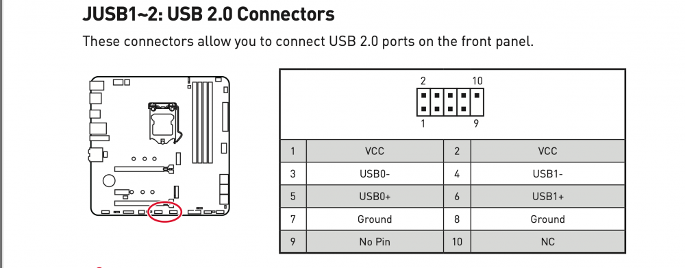

Something is going on and I do not think unraid likes this motherboard?
Any ideas where to start ?
Try a different USB port, ideally USB2 for the boot flash.  If problems continue, then try the Flash Remount plugin
Right now the only recourse is a reboot (and a parity check will ensue, but it'll be safe to cancel)
Thanks Mr @Squid
I do find this so strange while using a HP Gen8 fully loaded never had one issue, moved to latest GEN hardware and nothing but issues
Same USB Flash drive, prob only seen s a few reboots at best, as for using a USB2 I will try and find one and run a unregistered version before I try and tie my licence to another flash stick

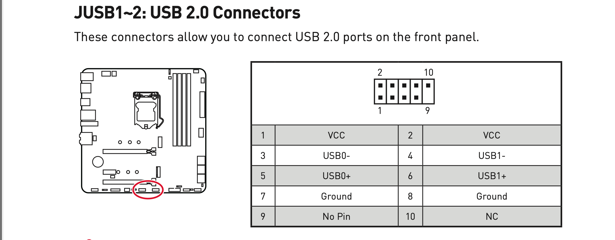

I I'm using an onboard USB2 port connector which is USB2 as shown in the attachment using a USB3 Flash that was used flawlessly in the HP like I mentioned bugger all use?
I've never seen so much hardware issues with virtually brand new hardware, just think the unraid OS isn't compatible with what I have put together? Very frustrating trying to get this to play nice, but will now try and find a USB2 Flash drive for use on the onboard USB2 instead of the current one I have my license on

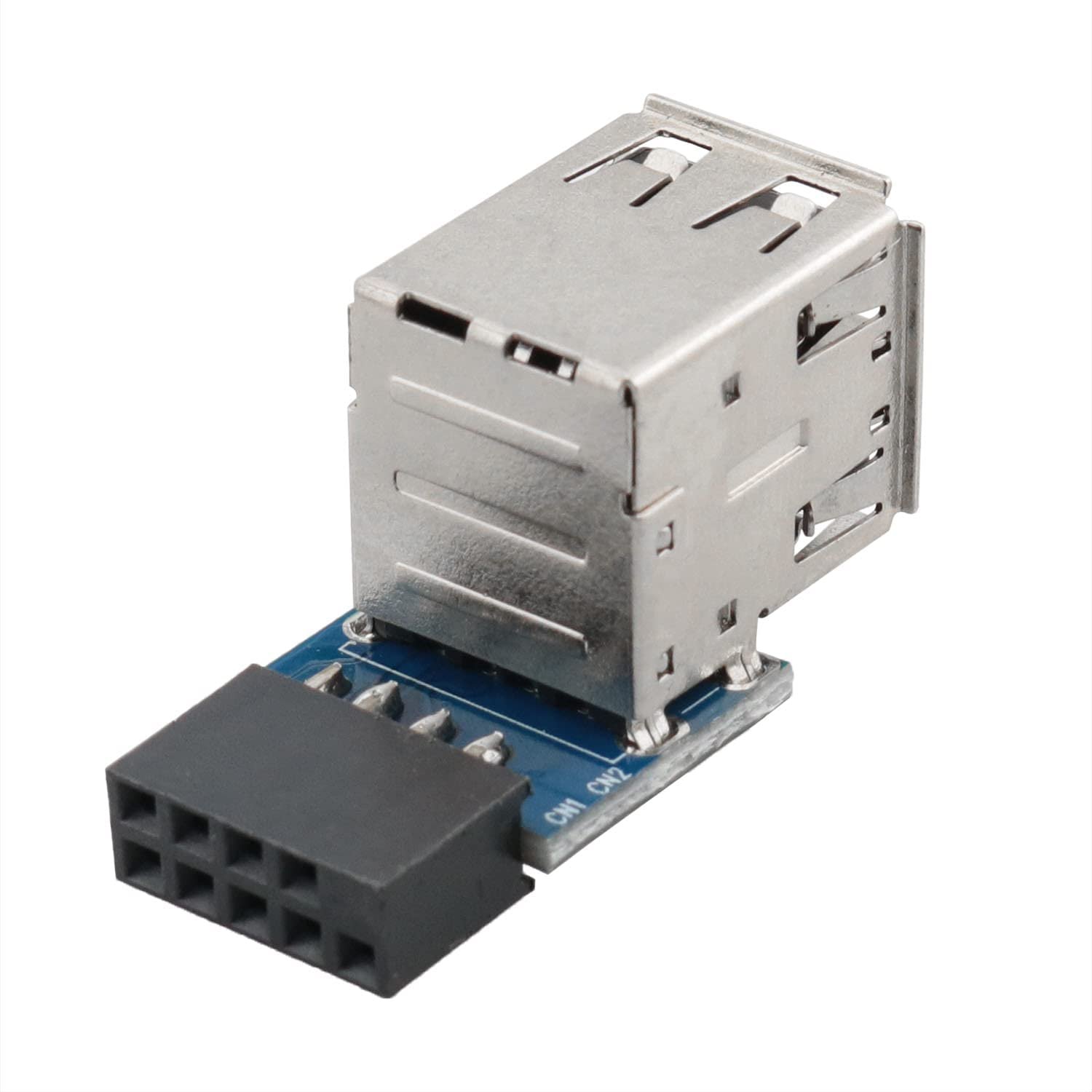

So far by adding this
mkdir /boot/config/modprobe.d/
echo -e 'blacklist btusb\nblacklist bluetooth' > /boot/config/modprobe.d/bluetooth.conf
and reboot will disable BT drivers
also changing onboard USB header adapter like this one
Error log looks clean and pre-clear has continued operating without dropping out, phew, maybe this is the winning combination..
Thanks again for the support Simon&Squid fingers crossed I can start the array once pre clear is done
