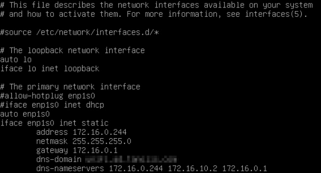

The story; Debian 11 VM installed. VM gets its IP address from router say 172.16.0.36. I edit /etc/network/interface file and change dhcp to static with IP address say 172.16.0.244. Restart network services. Go to router and reserve this IP address 172.16.0.244.
The fun begins. I can ping 172.16.0.244 till i restart unraid box. If i restart unraid box, i can not ping 172.16.0.244 but 172.16.0.36. My router also shows 172.16.0.36 as assigned address.
Here is IP config file;

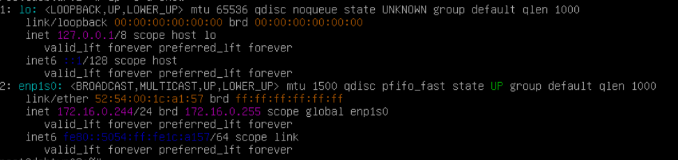

Here is connection info;
Any idea what's going on?
Changes to /etc/network/interfaces are useless if network manager is enabled.
Make sure to not use network manager, by disabling it:
sudo service network-manager stop
sudo update-rc.d NetworkManager remove
Then, reload interface:
ifdown enp1s0
ifup enp1s0
