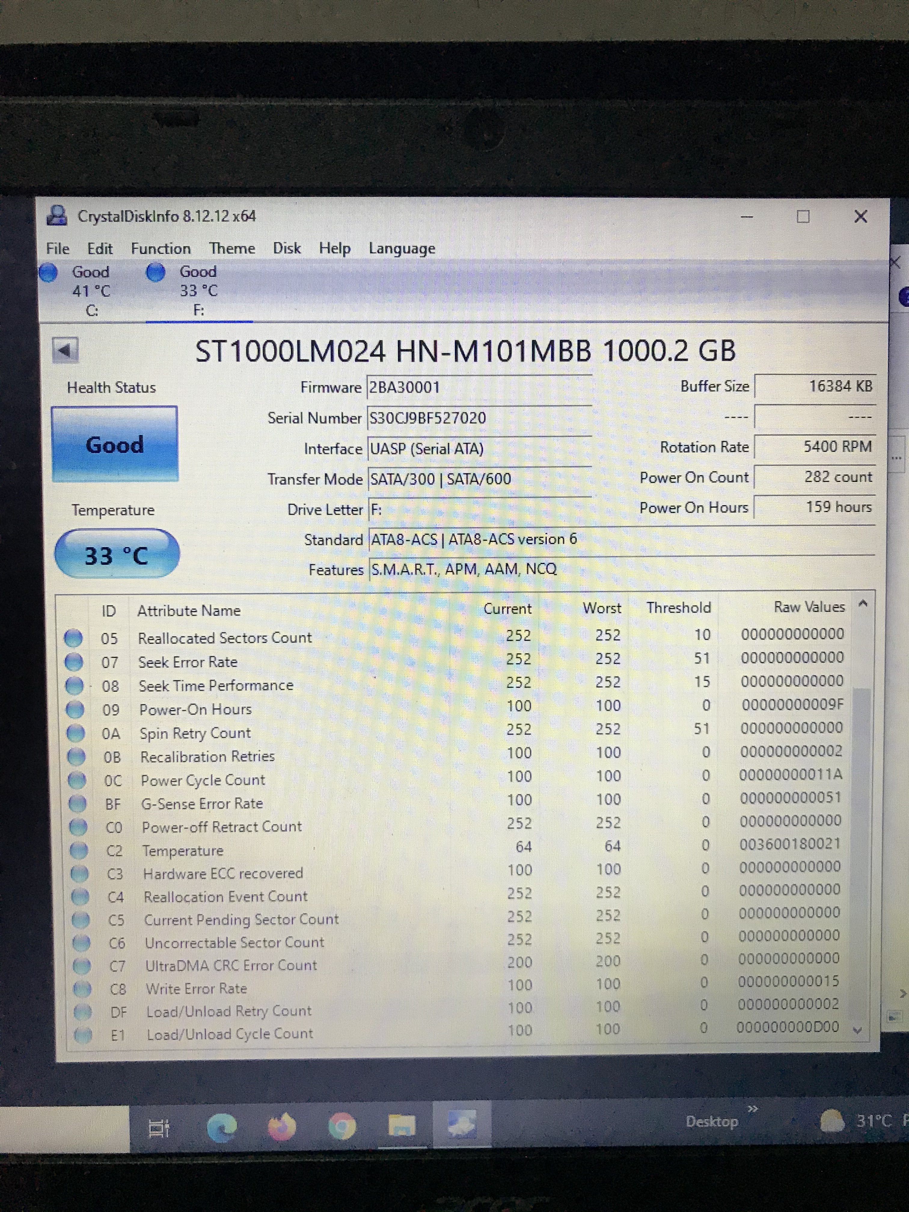

CDI Report: G-Sense Error Rate 51 and Write Error Rate 15
Should I be worried on G-Sense Error Rate 51 and Write Error Rate 15 on my Seagate External HDD CDI report?
G-Sense Error Rate
Current Worst Threshold Raw Values
100 100 0 000000000051
Write Error Rate
100 100 0 000000000015
https://imgur.com/a/yOKpUcy
3 minutes ago, Danvic said:
Should I be worried
No.
22 hours ago, JorgeB said:
No.
This is just normal?
For these don't look at the raw values, normaluzed value is 100, worst is 100, threshold is 0, so it can't be better than it is, it's still 100 and it never went lower.
