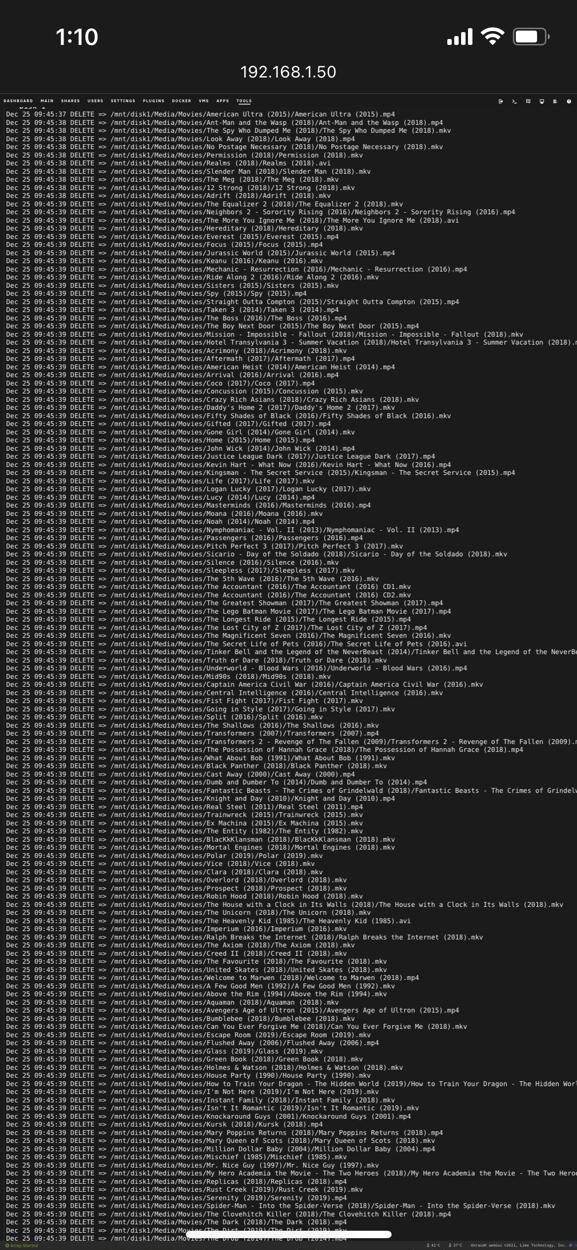

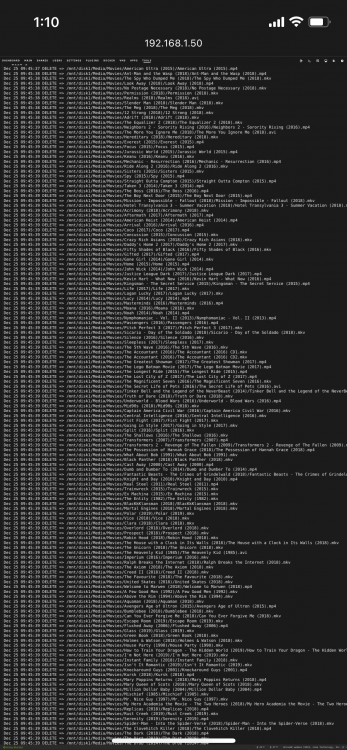

File activity shows all the deleted files, started this morning. But it does not show why, plus I have recycling bin setup but it didn’t catch any of them? Please someone look at my new diagnosis and see if u can help me figure this out

Witch is why I’m trying to pin point what has happened, is there any docker that does file recovery? Or will I have to fry one disk at a time in a windows machine? Also as I said I posted a updated diag to see if u can atleast see what could of happened file activity shows everything being deleted just doesn’t say why
