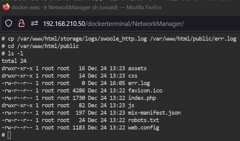

December 24, 20214 yr Author Could you open the docker terminal for the container (Icon -> Console) and execute this command `cp /var/www/html/storage/logs/swoole_http.log /var/www/html/public/err.log`. Then open the website and navigate to the `/err.log` location. It should download a file. Can you share that with me please?
December 24, 20214 yr 5 minutes ago, Sander0542 said: Could you open the docker terminal for the container (Icon -> Console) and execute this command `cp /var/www/html/storage/logs/swoole_http.log /var/www/html/public/err.log`. Then open the website and navigate to the `/err.log` location. It should download a file. Can you share that with me please? It's an empty file Now, I did just try it in Edge/Chromium. It worked that time! So maybe it's a Firefox thing /shrug
