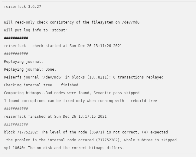

Thanks for both replies. I guess I should so some more digging first. I ran the reiserfsck on the disk in question and got the below output. This NAS has been out of action for a while, and I've lost track a little of the whole unRAID solution but I read elsewhere I should not be using reiserfs?

Any thoughts on what the output of the check means?

You need to run reiserfsck again but using with the --rebuild-tree option.
