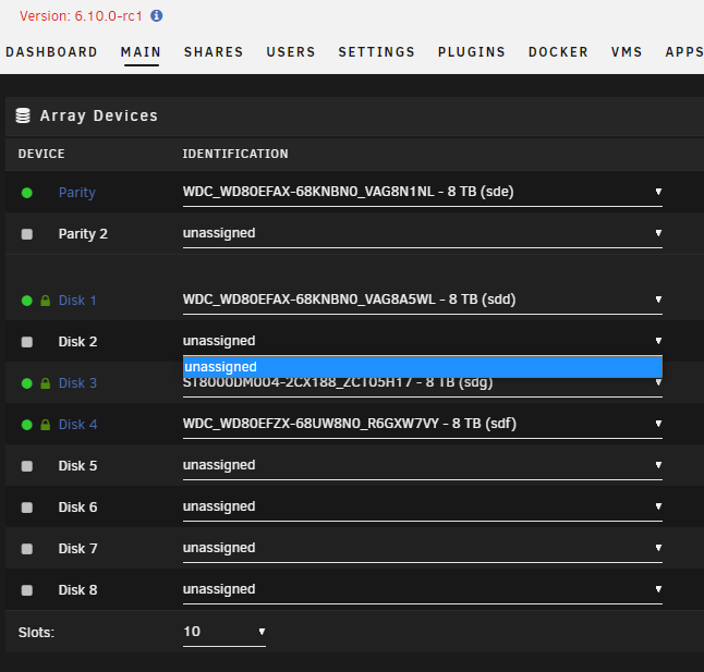

I stopped the array, and selected the new disk from the drop-down menu in the MAIN tab - 'Array Devices'. The page refreshed after selection, but the drop-down set itself back to 'unassigned', and now the disk doesn't appear in the drop-list.  My array is still 3 drives + cache. It should be 4 drives + cache with the new disk added.

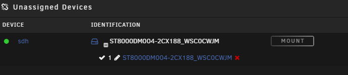

I can see the disk in "unassigned devices".  How can I add the new disk to the array?

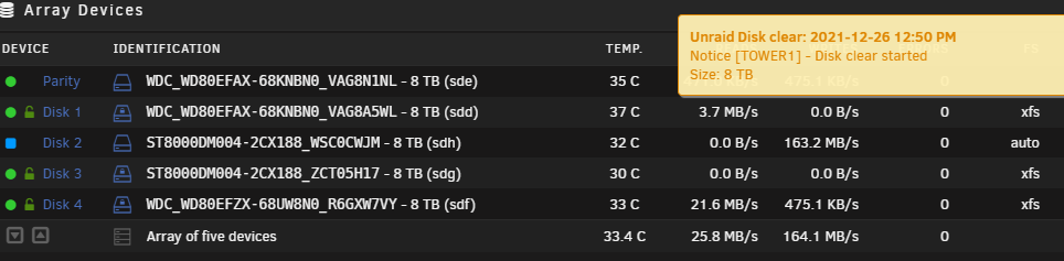

I restarted the server and tried again. It has allowed the drive to be added this time, and it's (annoyingly) clearing the drive, which was supposed to be done by the preclear script!
That means for some reason the pre-clear signature on the drive was not recognised.

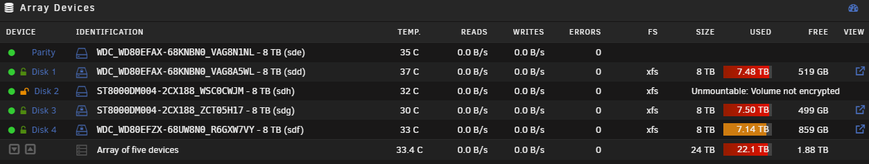

Unraid finished clearing my disk overnight. I deleted the drive's 'Historic Devices' entry in the Main tab GUI, then formatted the disk as Unraid was reporting it can't be added because it was not formatted.

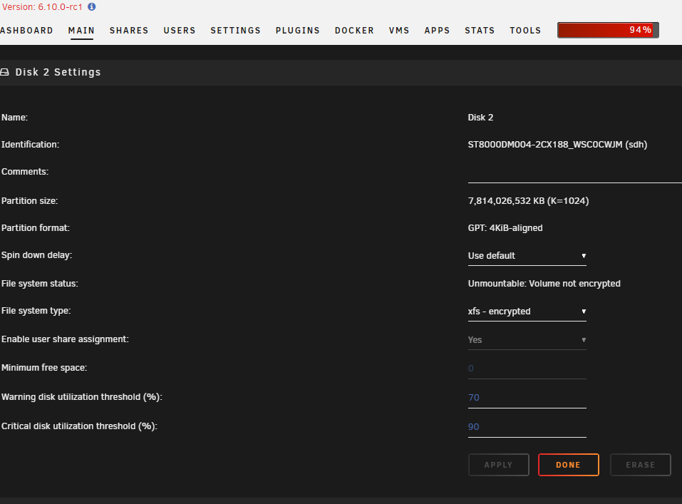

Following the format, which only took a few seconds(?), the disk is showing as "unmountable: volume not encrypted".
The disk settings are showing as "encrypted". So, again, i'm stuck.  What do I need to do to add this new disk?

The explanation sounds a bit strange :( you have to add the disk to the array BEFORE formatting it, and your description sounds as if this was not what happened?
The disk was added to the array yesterday, then Unraid started a disk clear.
I've fixed this by formatting again. The disk is now part of the array and working correctly.  Next: Move files to the new disk from the old disk to re-balance usage.
