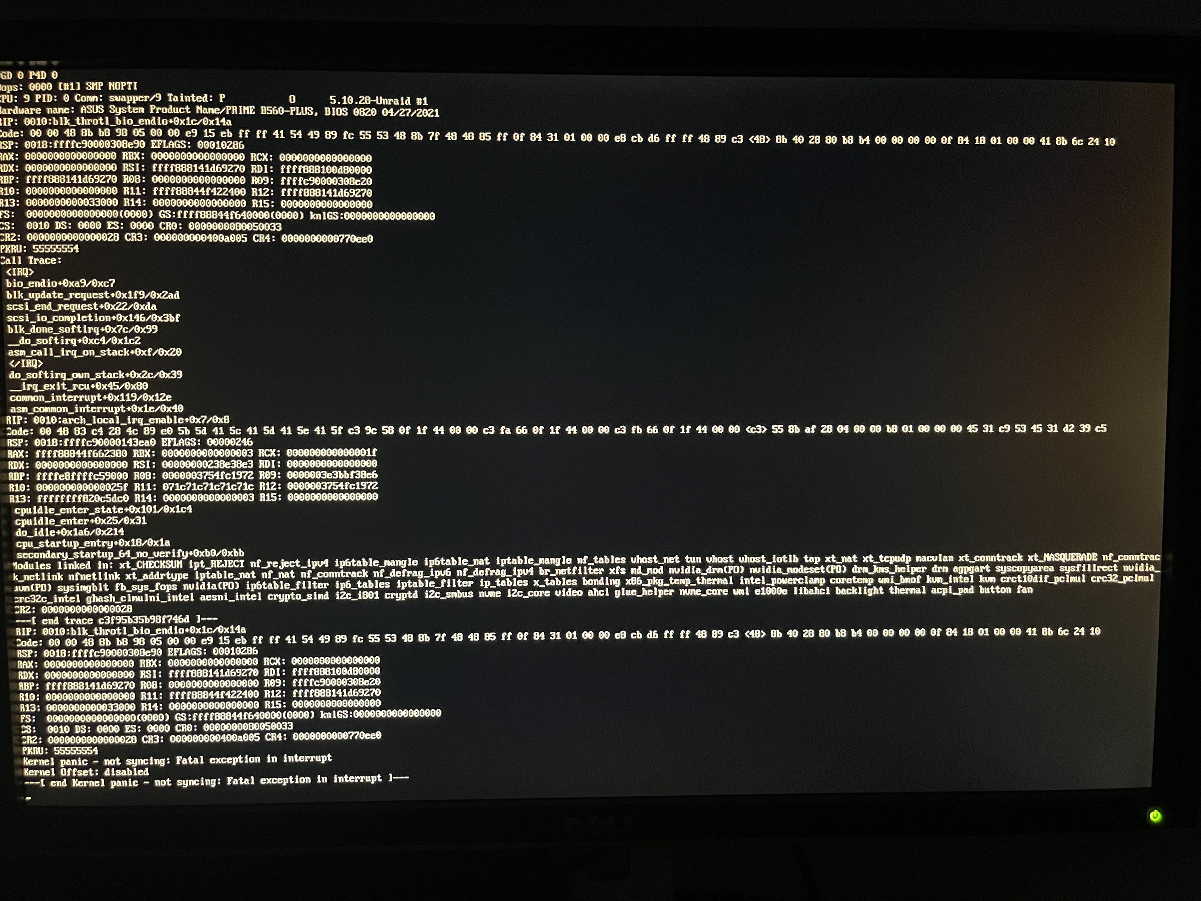

Kernel panic - not syncing : Fatal exception in interrupt
If this is not a software issue with unraid, jeez, I don't even know where to start.

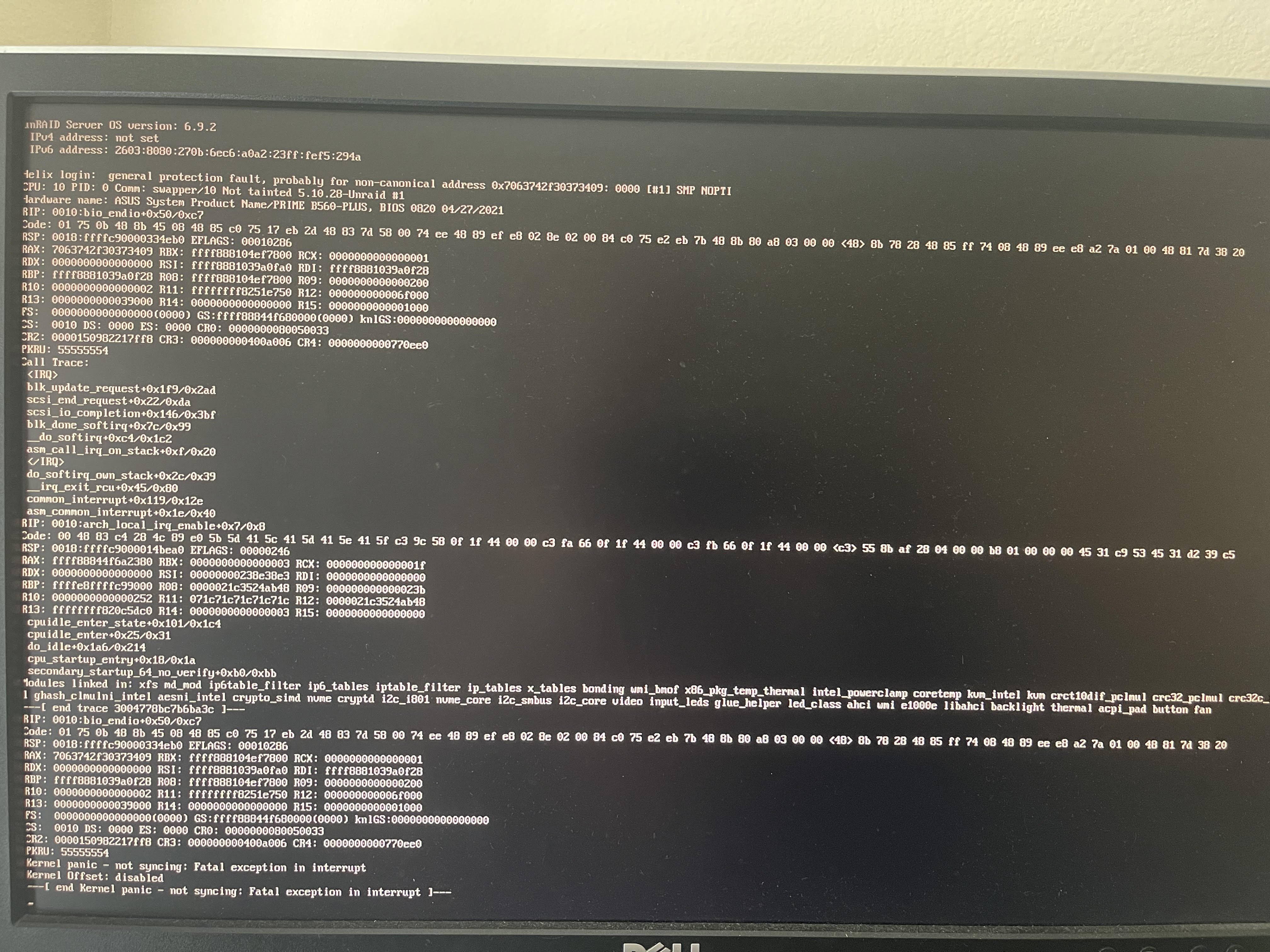

is there any chance this is related to the system time?
Dec 31 12:50:54 Helix ntpd[2023]: kernel reports TIME_ERROR: 0x41: Clock Unsynchronized
Dec 31 13:14:59 Helix kernel: md: recovery thread: P corrected, sector=891215144
Dec 31 13:14:59 Helix kernel: md: recovery thread: P corrected, sector=891215152
Dec 31 13:14:59 Helix kernel: md: recovery thread: P corrected, sector=891220760
Dec 31 13:23:26 Helix kernel: general protection fault, probably for non-canonical address 0x7063742f30373409: 0000 [#1] SMP NOPTI
Dec 31 13:23:26 Helix kernel: CPU: 10 PID: 0 Comm: swapper/10 Not tainted 5.10.28-Unraid #1
Dec 31 13:23:26 Helix kernel: Hardware name: ASUS System Product Name/PRIME B560-PLUS, BIOS 0820 04/27/2021
Dec 31 13:23:26 Helix kernel: RIP: 0010:bio_endio+0x50/0xc7
Dec 31 13:23:26 Helix kernel: Code: 01 75 0b 48 8b 45 08 48 85 c0 75 17 eb 2d 48 83 7d 58 00 74 ee 48 89 ef e8 02 8e 02 00 84 c0 75 e2 eb 7b 48 8b 80 a8 03 00 00 <48> 8b 78 28 48 85 ff 74 08 48 89 ee e8 a2 7a 01 00 48 81 7d 38 20
Dec 31 13:23:26 Helix kernel: RSP: 0018:ffffc90000334eb0 EFLAGS: 00010286
Dec 31 13:23:26 Helix kernel: RAX: 7063742f30373409 RBX: ffff888104ef7800 RCX: 0000000000000001
Dec 31 13:23:26 Helix kernel: RDX: 0000000000000000 RSI: ffff8881039a0fa0 RDI: ffff8881039a0f28
Dec 31 13:23:26 Helix kernel: RBP: ffff8881039a0f28 R08: ffff888104ef7800 R09: 0000000000000200
Dec 31 13:23:26 Helix kernel: R10: 0000000000000002 R11: ffffffff8251e750 R12: 000000000006f000
Dec 31 13:23:26 Helix kernel: R13: 0000000000039000 R14: 0000000000000000 R15: 0000000000001000
Dec 31 13:23:26 Helix kernel: FS: 0000000000000000(0000) GS:ffff88844f680000(0000) knlGS:0000000000000000
Dec 31 13:23:26 Helix kernel: CS: 0010 DS: 0000 ES: 0000 CR0: 0000000080050033
Dec 31 13:23:26 Helix kernel: CR2: 0000150982217ff8 CR3: 000000000400a006 CR4: 0000000000770ee0
Dec 31 13:23:26 Helix kernel: PKRU: 55555554
Dec 31 13:23:26 Helix kernel: Call Trace:
Dec 31 13:23:26 Helix kernel: <IRQ>
Dec 31 13:23:26 Helix kernel: blk_update_request+0x1f9/0x2ad
Dec 31 13:23:26 Helix kernel: scsi_end_request+0x22/0xda
Dec 31 13:23:26 Helix kernel: scsi_io_completion+0x146/0x3bf
Dec 31 13:23:26 Helix kernel: blk_done_softirq+0x7c/0x99
Dec 31 13:23:26 Helix kernel: __do_softirq+0xc4/0x1c2
Dec 31 13:23:26 Helix kernel: asm_call_irq_on_stack+0xf/0x20
Dec 31 13:23:26 Helix kernel: </IRQ>
Dec 31 13:23:26 Helix kernel: do_softirq_own_stack+0x2c/0x39
Dec 31 13:23:26 Helix kernel: __irq_exit_rcu+0x45/0x80
Dec 31 13:23:26 Helix kernel: common_interrupt+0x119/0x12e
Dec 31 13:23:26 Helix kernel: asm_common_interrupt+0x1e/0x40
Dec 31 13:23:26 Helix kernel: RIP: 0010:arch_local_irq_enable+0x7/0x8
Dec 31 13:23:26 Helix kernel: Code: 00 48 83 c4 28 4c 89 e0 5b 5d 41 5c 41 5d 41 5e 41 5f c3 9c 58 0f 1f 44 00 00 c3 fa 66 0f 1f 44 00 00 c3 fb 66 0f 1f 44 00 00 <c3> 55 8b af 28 04 00 00 b8 01 00 00 00 45 31 c9 53 45 31 d2 39 c5
Dec 31 13:23:26 Helix kernel: RSP: 0018:ffffc9000014bea0 EFLAGS: 00000246
Dec 31 13:23:26 Helix kernel: RAX: ffff88844f6a2380 RBX: 0000000000000003 RCX: 000000000000001f
Dec 31 13:23:26 Helix kernel: RDX: 0000000000000000 RSI: 00000000238e38e3 RDI: 0000000000000000
Dec 31 13:23:26 Helix kernel: RBP: ffffe8ffffc99000 R08: 0000021c3524ab48 R09: 000000000000023b
Dec 31 13:23:26 Helix kernel: R10: 0000000000000252 R11: 071c71c71c71c71c R12: 0000021c3524ab48
Dec 31 13:23:26 Helix kernel: R13: ffffffff820c5dc0 R14: 0000000000000003 R15: 0000000000000000
Dec 31 13:23:26 Helix kernel: cpuidle_enter_state+0x101/0x1c4
Dec 31 13:23:26 Helix kernel: cpuidle_enter+0x25/0x31
Dec 31 13:23:26 Helix kernel: do_idle+0x1a6/0x214
Dec 31 13:23:26 Helix kernel: cpu_startup_entry+0x18/0x1a
Dec 31 13:23:26 Helix kernel: secondary_startup_64_no_verify+0xb0/0xbb
Dec 31 13:23:26 Helix kernel: Modules linked in: xfs md_mod ip6table_filter ip6_tables iptable_filter ip_tables x_tables bonding wmi_bmof x86_pkg_temp_thermal intel_powerclamp coretemp kvm_intel kvm crct10dif_pclmul crc32_pclmul crc32c_intel ghash_clmulni_intel aesni_intel crypto_simd nvme cryptd i2c_i801 nvme_core i2c_smbus i2c_core video input_leds glue_helper led_class ahci wmi e1000e libahci backlight thermal acpi_pad button fan
Dec 31 13:23:26 Helix kernel: ---[ end trace 3004778bc7b6ba3c ]---
