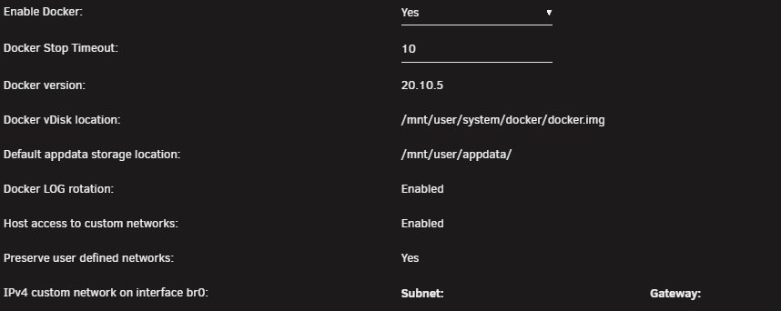

Enable "Host access to custom networks:"...OK
Enable "Preserve user defined networks:"...OK

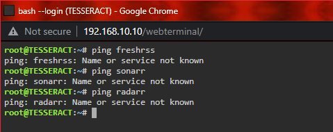

test connection via ping...
i cannot ping or nslookup from within any docker containers
ive restarted docker, ive restarted the containers
the only thing i haven't done is restarted the unRAID
i'm missing something...but i don't know what it is
