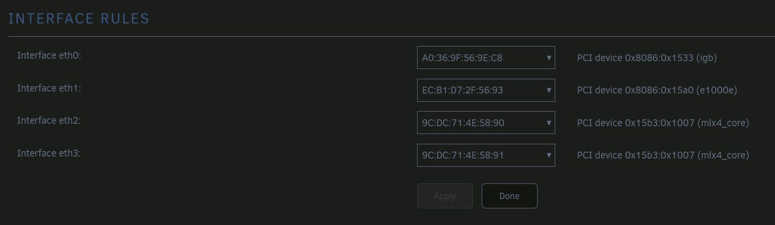

Hi everyone,
I'm fairly new to Unraid, love it so far! Very intuitive and easy to work with.
However, I'm encountering some issues with changing the interface rules.
As you can see in the screenshot i have a duplicated MAC-address on eth3/eth4. This comes from a PCI 10GBit HP NIC.
The PCI-card only has 2 SPF slots but somehow Unraid sees 3. Because of this when I try to change anything in this field Unraid would not allow this because of the duplicated MAC-address, Is there a way to resolve this duplicated MAC issue?
Attached is the diagnostics report if useful.
Server is running Unraid 6.8.2
Best regards, Spark
Sparktime-unraid-diagnostics-20211228-1801.zip

Ill take a stab at this, what model of Nic? I had a similar issue with Mellanox ConnectX3 MCX312A that I was able to fix.  Duplicate Macs are the result of a bad or improper firmware flash so if you bought them off eBay like that, seller didn't understand how to flash when upgrading firmware :) Basically I just flashed the static Mac and guid again.
https://forums.servethehome.com/index.php?threads/mellanox-connectx-3-en-duplicate-permanent-mac-address-issue.24790/
Im sure that's probably your issue, though I don't know how to flash HP cards (should be some documentation online)
This could be the problem! When I run a "lshw -class network" command, it says it runs a "MT27520 Family [ConnectX-3 Pro]" chipset, seems quite similar to you card.
I bought it from a friend who took it out of a old company server, we both don't know if its been flashed before. When I'm back home, I'll try and flash the card, if I can find how.

Welp that's a hard no.  I tested with a single port and it flashed fine, put a dual port in and unraid had a hernia. It adds a duplicate Mac every time I reboot so I am going to file a bug report in the bug report section as this hasn't gotten any replies in...almost ever :) I can replicate though, I tested with a dual port sfp+ card and it does indeed have duplicates in the OS.
OK I filed a bug report, its not an unraid issue, still trying to track down how unraid determines the nic as I received conflict information, that unraid does not use the same Mac for multiple interfaces, and yet a clean install assigns 1 Mac for port 1 and 2 Macs for port 2.  ill report back if I find info.  im going to stand up a Debian server to see if I see the same result and that will 100% determine if unraid related.
Edit: see this:
Edited by Jclendineng
Unraid uses "udev" to discover the hardware components of your system, including the installed NICs.
Your NIC seems to report the wrong information and issues the same MAC address twice.
See if a firmware update exists for your NIC.
Finally had time to fiddle with the NIC again.
Did a firmware upgrade to the latest with Ich777`s Mellanox Firmware Tools as suggested, sadly Unraid still reports a extra port/MAC address.
mstflint only reports 2 MAC addresses which should be correct. I can manually disable the port from the network-rules.cfg but this is quite the pain and shouldn't be the answer.

After updating to 6.10.1 it seems to be fixed! No more duplicated MAC addresses!
Later today I'll try and change the network configuration and see if it works and is persistent between reboots.
Yesterday I took the dive and updated my secondary unRAID to 6.10.1, then later my primary once I saw everything was working well.
In particular regard to the 10Gbit dual ConnectX-3 cards, I did some rudimentary testing after upgrade on both systems (I had 164 days solid uptime on my secondary 😁) and found that it works but (at least in my case) not perfectly. I'm going to be keeping an eye on it still, but I'll try to explain my findings.
So after upgrading my secondary (My less fussy system because I hardly ever mess with it), I saw that the installed cards were all listed but they were listed as eth0 (mlx4_core), eth2 (mlx4_core) and eth3 (igc). So I went to the network.cfg and network-rules.cfg, and changed them to be eth0, eth1, eth2, and rebooted. Upon reboot I found the same issue where the cards were duplicated and had become eth0 (mlx4_core), eth1 (igc), eth2 (mlx4_core duplicate?), eth3 (mlx4_core).
So I thought "uh oh" and edited the network.cfg and network-rules.cfg to reflect the original setup eth0, eth2, eth3. That seemed to work again, and I fully rebooted 3 times to check confirm that the configuration would persist through restarts. Seems good, so then I thought upgrade the primary unRAID to see what's really up.
Upon upgrading my primary unRAID, I immediately saw that 4 cards were listed, eth0 (mlx4_core), eth1 (r8169), eth2 (mlx4_core duplicate?), eth3 (mlx4_core). So I thought to immediately try to duplicate the eth0+2+3 configuration of the secondary. After setting network.cfg and network-rules.cfg and rebooting, that seemed to work and no duplicated were present. They showed up as eth0 (mlx4_core), eth2 (mlx4_core), eth3 (r8169).
I rebooted my primary server a further 3 times, to check that the card assignments were persistent.
It looks at this moment like the configuration stuck, but I'm still hesitant to change anything. I'm planning in the coming days to reboot my primary a few more times and see if anything switches around, or goes strange.
So far, so good though. 👍

The duplicates are created BY THEMSELVES before any editing, and I documented the only ways I found to fix this known issue.
If you check my thread, editing the network.cfg and network-rules.cfg manually is the ONLY way to make it work, and the GUI gets broken from edits and refuses to save when duplicate cards are created. This is tested on separate machines independently, and others have reported this all over the forum. So, I followed my previous method and this is the result.
I'm saying clearly that this issue is NOT FIXED, but it seems to be tentatively stable in the GUI, at least in my current testing. I'm happy about that so far.

Yeah, I think this happens because the GUI tries to write all the MACs back to the config file, but validation fails because there is a duplicate in configuration.
So its doing what its supposed to do and just fails, and you're stuck staring at the GUI with broken dual MAC addresses that you didn't put there.
Only way to fix it is to remove the duplicate manually in the files, and the GUI becomes usable again.
