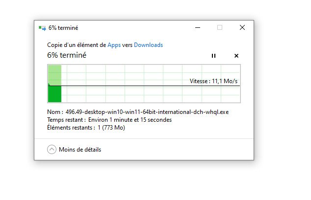

I got very slow transfer speed between my unraid server and windows 10
When i want to copy a file from unrraid to my C ssd drive, i only got 10MO/S, but i only got 1gigabit card.

why this is so slow ?

i try under linux and got 116 MO/S
so i uninstall the driver, delete the network adaptateur
and after fresh install of the network card with default configuration, i can transfer file to 116MO/s
problem solved!
