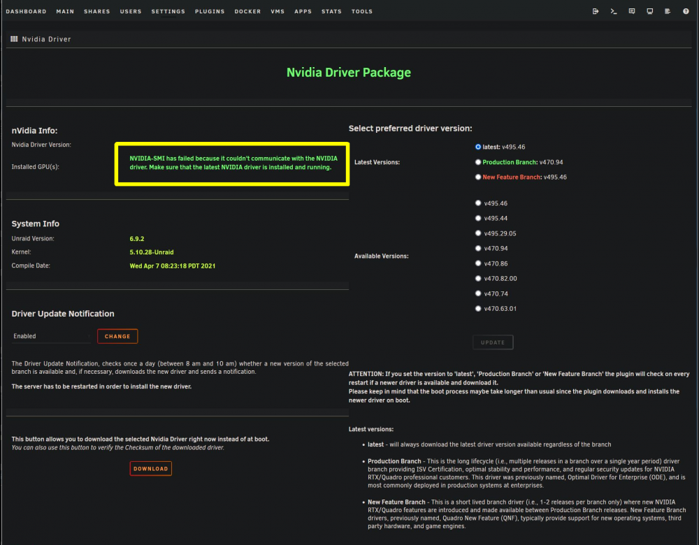

Thank you for the tip.  I have my UnRaid box setup to bootup using the "UnRaid OS GUI Mode".  Therefore, it did not cross my mind to reach the UnRaid webGUI from another system connected to my home network. In short, I was able to get access to the Plugins tab and the screen capture below shows the Nvidia plugin prompting a problem I have boxed in YELLOW:
It has auto-upgraded itself to v495.46.  So I changed it to Production Branch v470.94 and then rebooted the machine. That fixed the problem! Thank God everything got back to the way it was working 3-4 months ago which was the last time I fired up the machine.
The lesson I learned here is to not have the Nvidia driver set to the LATEST option.  I need to figure out how I can LOCK my Nvidia driver to the Production Branch option so it no longer auto updates.  This way one can avoid such Nvidia driver headaches.
