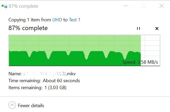

Just tried transferring a movie file across to the UnRaid server. It works file for a time - transferring at approx 113 MB/s, then just after around 10% of a 25Gb file, the transfer speed drops to 2MB/s (according to Explorer). After about a minute or so, the speed ramps back up to what it was before, and then it repeats - slows right down....almost like it's paused, before ramping up again. I've had the file transfer time-out several times. I've NEVER experienced this before. I don't have a cache drive. I also used TeraCopy to do the file transfers, but - for whatever reason - I seem to experience more 'time-outs' using that tool.
Do I have an issue on my UnRaid server, is there a disk issue, or should I investigate further - if so, what should I do?

Is this transferring to the array or to the cache?
The way the system works (and it's most noticeable when going to the array) is that transfers get cached in RAM and slowly written to the drive.  Eventually you get to the point where RAM is full and the system is waiting to clear it out a bit by actually writing it to the drive.
Generally, to the array, on average you're looking at roughly say 60MB/s sustained.  The "pauses" aren't particularly important as what you're basically looking at is the average speed for the entire transfer or the total time it takes).
You can speed up this by enabling reconstruct write in Settings - Disk Settings which speeds up writes at the expense of power (all drives have to be spinning)
Directly to a cache drive (particularly SSD) these dips are massively diminished due to the faster writes to it

No.  What I'm saying is that on average writes to the array average around 50-60MB/s (YMMV), but the OS caches transfers in RAM (hence the 113MB/s -> which is the line speed of 1G network)
Eventually the RAM cache gets filled and the system has to slow down transfers because it needs to flush to the hard drive.  This results in the dips you're seeing because it can't sustain 113MB/s transfer rate since no matter how you cut it the array can't keep up in transfer speeds.
You're not particularly running out of memory.  If the system didn't cache the writes at all, you'd see a solid ~60MB/s transfer rate.  Since it cache's at the end of the transfer, the average rate over the time frame is going to be ~60MB/s but with the peaks and the dips reflecting the caching.

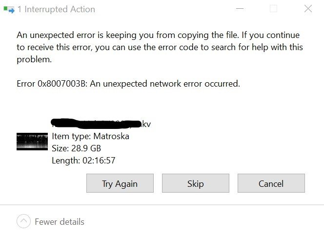

Hmmm....perhaps I understated the original issue I'm experiencing. I went back and reviewed the wording in my original post. What I DIDN'T say was the transfers are consistently timing out. I understand, from the responses given earlier, that the transfer speed will fluctuate - and that's fair enough, BUT the transfers are often FAILING....giving a message similar to this....(see attached).
I followed your advice, went into the UnRaid Disk Settings and enabled 'reconstruct write'. However, even after doing that, the transfers are still failing....timing out? The transfer speed sometimes drops down to zero, and not long after that I'll get the error message.
In the past, file transfers - especially of large files - has been a little slow, but they've almost never failed before....and this is happening consistently now.
I'm happy to investigate installing an SSD as a cache drive, but does this current behavior point to a different issue?

No idea exactly what is causing your problem.
the only time I got similar symptoms it turned out in the end to be the network on the Windows client that was failing under heavy load.

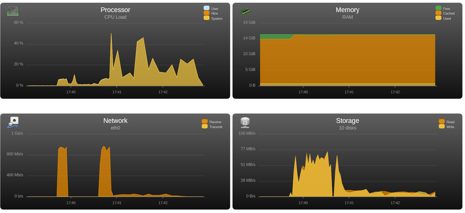

Don't know if it's helpful/useful, but here's a snapshot of the 'stats' during the transfer....
...and I should have specified....the transfer failed again.
I took a look at the syslog file under the logs directory. I found the first occurrence of something that looks like an issue matching mine (I really don't know much about this stuff, so I'm just guessing) the incident happened yesterday, and the times the same, or similar incident happens likely lined up with the times I attempted to transfer the file, and failed. The last time was 8:45AM this morning. Here are the 'selected highlights'.
To me (again, I'm not an expert so could still be miles off track) it looks like some kind of memory issue, but it would be GREAT to get some expert oversight to confirm or deny, and to (hopefully) advise next steps....

17 hours ago, Roscoe62 said:
Jan  4 17:48:52 Server kernel: Out of memory: Kill process 17308 (smbd) score 1 or sacrifice child
This indicates smbd was oomed (process killed because out-of-memory)
Do you have any VMs? How many dockers?
No, no VMs, and only 2 dockers - neither are running - don't use them any more.
