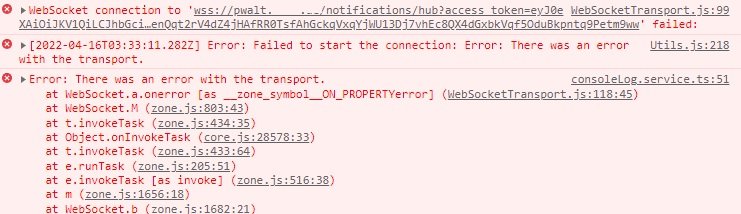

I think you missed setting up WebSocket. Without, Vaultwarden doesn't sync instantly, and you have to relog or sync other Applications manually. Maybe it was just me, but when I check my Browser Console (F12 > Console), I had multiple WebSocket errors.

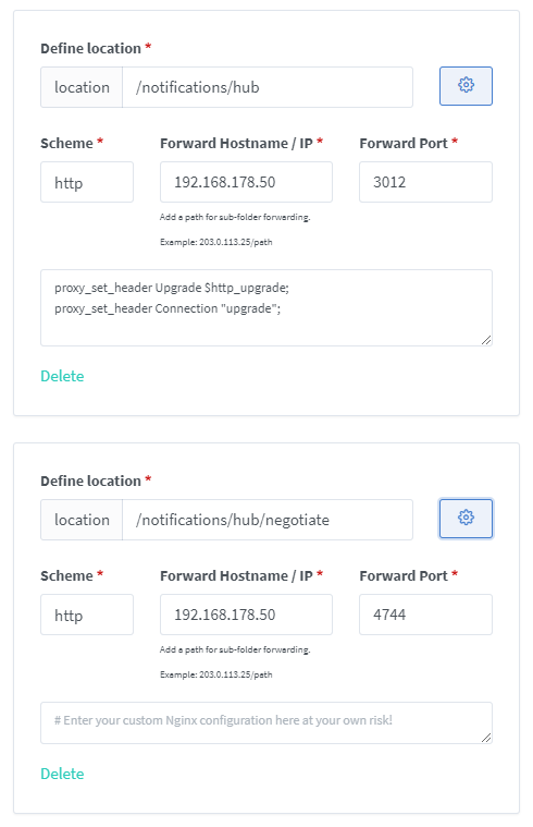

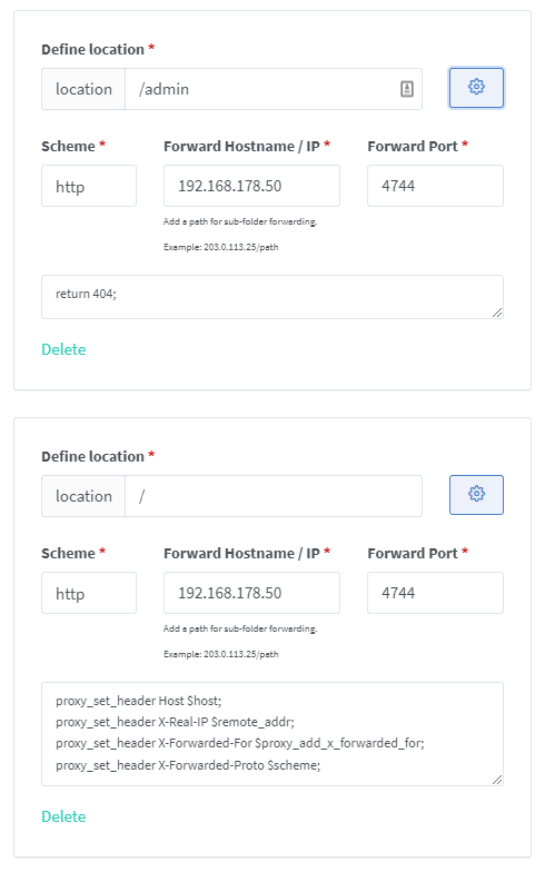

Or if you want to use the Custom locations Tab, here's what it looks like.
image.thumb.png.ab33e085c68cd3ade5a799592f5401d7.pngimage.thumb.png.7dcbac9074bf86bc04d3956441ccbacb.png
When you now refresh Vaultwarden, log in to your vault and check the Browser Console (F12 > Console), there should be no red error and something like this.
[date] Information: WebSocket connected to wss://<domain>/notifications/hub?access_token=<token>
