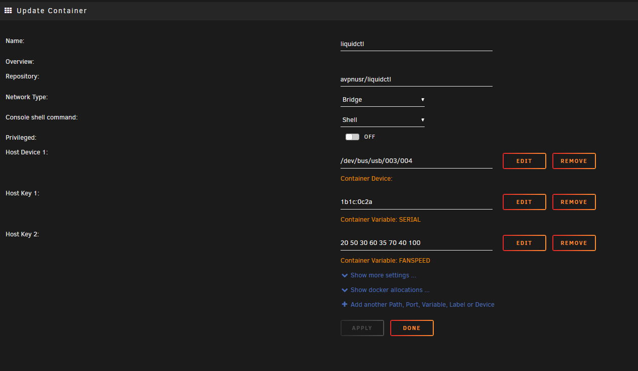

Recently upgraded my server chassis to a rosewill l4500u. Replaced the stock fans with 6 Corsair AF120's connected through the iCUE commander core xt.
Is there anyway to control the fan speed through the controller or is there another way i could pursue?
I've tried following this docker container
https://hub.docker.com/r/avpnusr/liquidctl

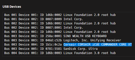

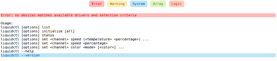

Im not sure if i have the correct variables, the container is not locating the USB device
Any suggestions would be great, thanks.
