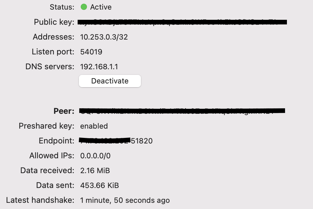

What is it that I'm missing? Here is a screenshot from the client's end on the peer settings:

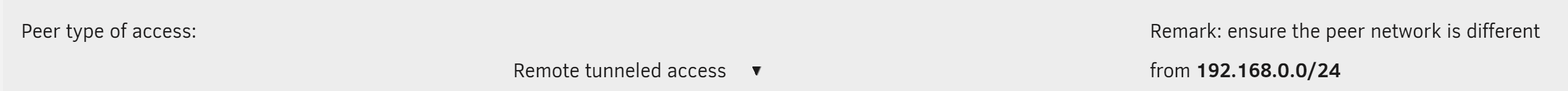

If you want all traffic to go through the VPN tunnel then the "Peer type of access" should be set to "Remote tunneled access". The WireGuard settings page should then show a warning similar to this, advising that the peer's network IP range cannot be the same as Unraid's network:

Your listening ports of peer and server needs to be the same. (51820)
Set your DNS server to be the server wireguard ip address.. (10.253.0.xx)
