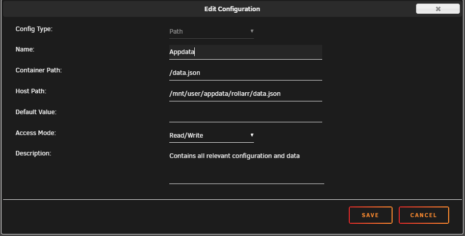

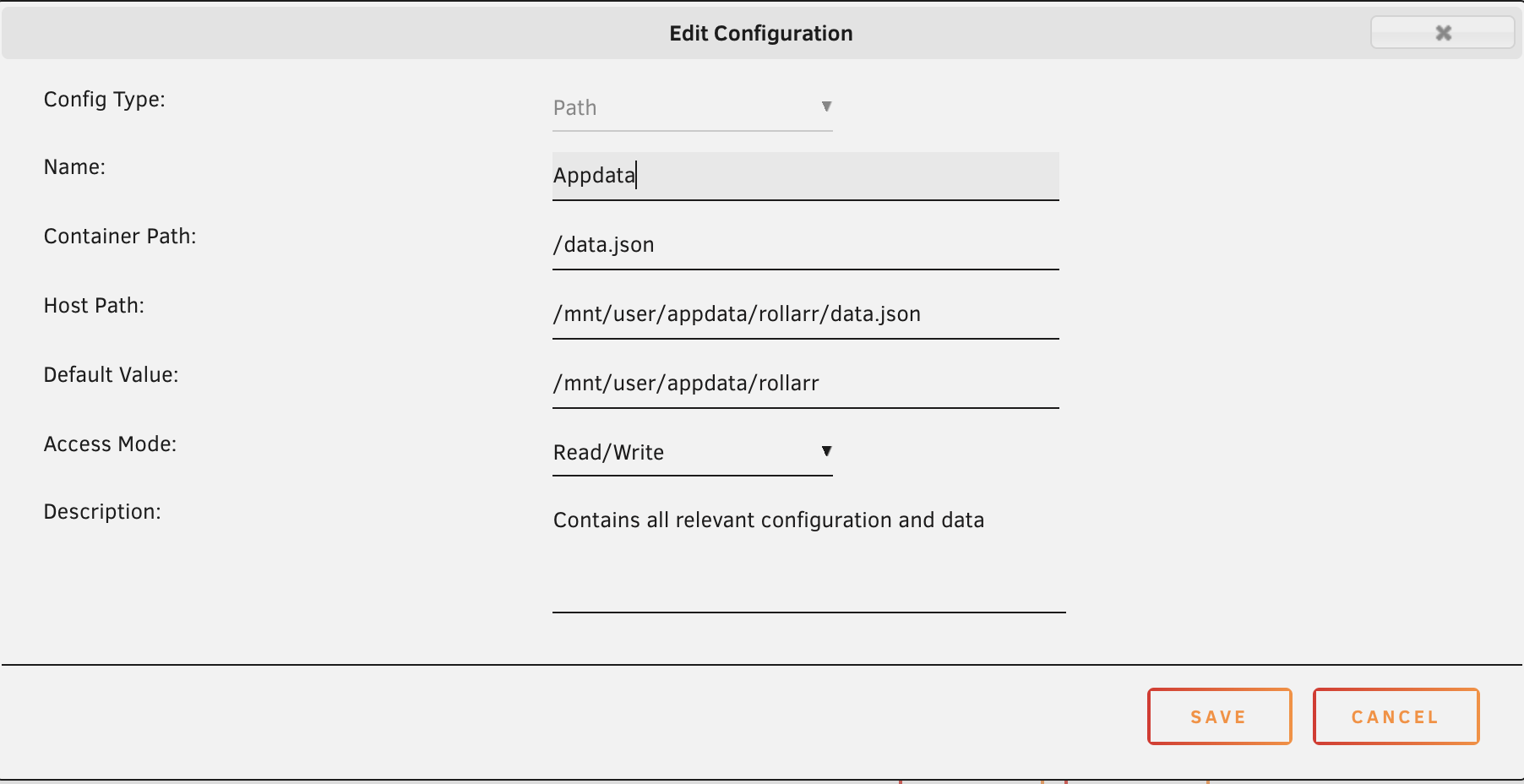

Okay so @cammelspit, @veizour, @SuperKing, @Alphacosmos and @nirav
I found a temporary way to fix this. Beware though it is temporary and involves some work. So you might want to wait for an official solution.
  1. Delete your Rollarr container and image
  2. Create in your '/mnt/user/appdata/rollar' directory a new file with the name 'data.json'
  3. Enter the following lines into the 'data.json' file
    {"URL":""}
  4. Reinstall the Rollarr app and change the 'Appdata' path variable to the one shown in the attached file.
I think that should work. You essentially mount a single file instead of the entire directory. The creation of the file beforehand is necessary because Docker would otherwise jsut create a directory with the name 'data.json'.
    {"URL":""}

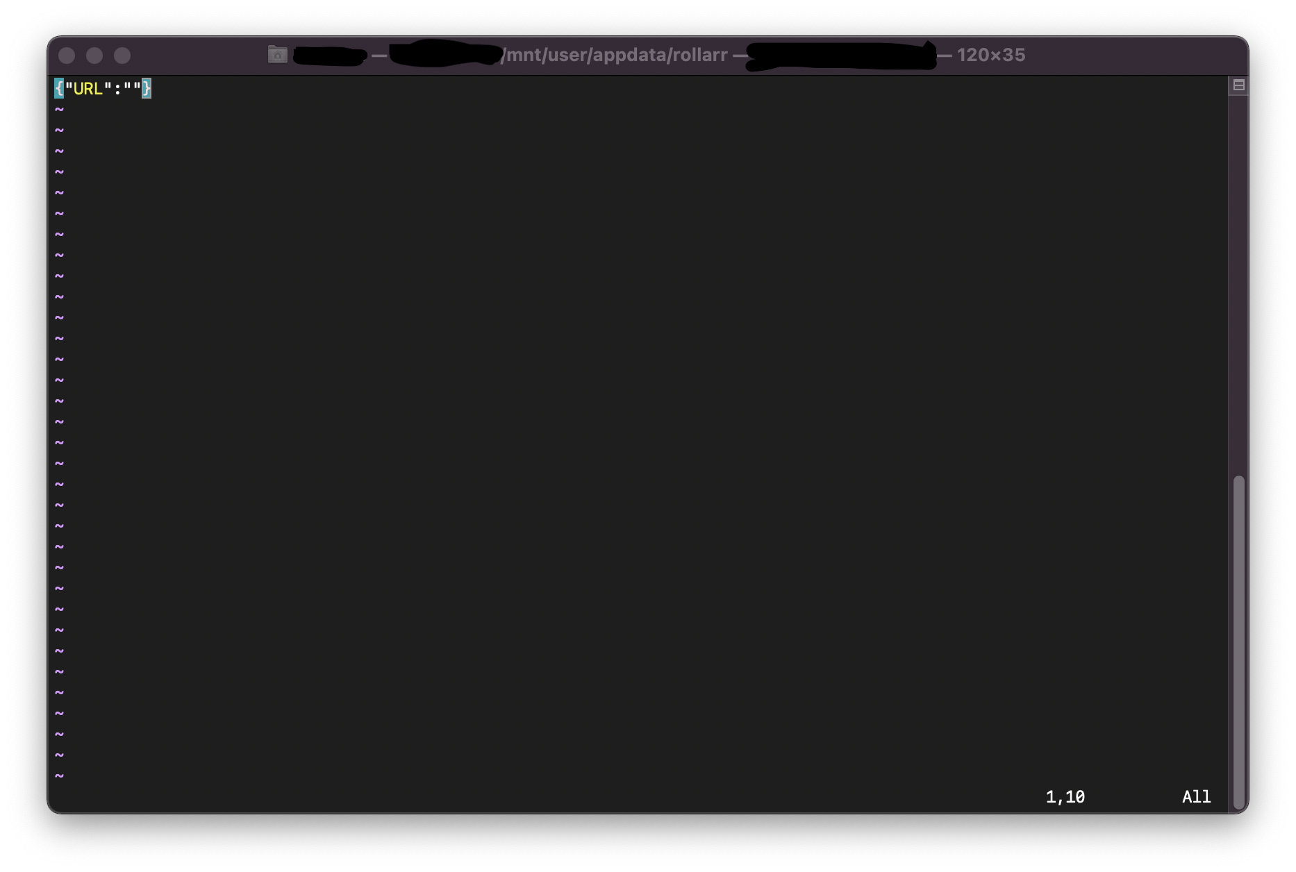

I followed your guide and the container now starts up, although when i look inside the data.json file i created no more data has been written to then the line i added and after a restart all configuration is still lost :/image.thumb.png.b182dd15cf4d606992c243feeba6ecca.png689279564_Screenshot2022-01-07at13_19_14.thumb.png.6c4e8495ffdf03e0c96a979aeaedd5a8.png

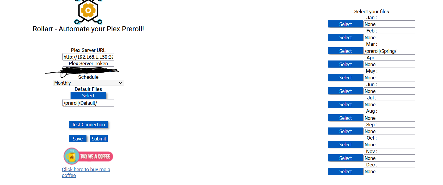

I'm a bit lost and hoped to get some guidance here.
I followed the steps in the first post. Created the data.json file in the appropriate directory. Installed the Rollarr docker.
I confirmed in my Plex settings that I have the exact same location for my preroll files.
Even when I fill out the server location, plex token, default location, I press save and get the OK screen. I press Submit and get the OK screen.
If I check the .json file there is no extra info written in it, just the one line I created it with. When I play a movie in Plex, no preroll plays.
I've also tried setting up the Monthly, but still no prerolls play.
So, besides it just not working for me, couple of questions. What address am I supposed to use for the Plex server. Do I just put the IP address, or no I also need to include the port number (xxx.xxx.xxx.xxx:32400)?
When I press the Test Connection button, nothing happens. Doesn't matter what I have for an address, I get no reaction when I click it. What should I be seeing when I try it?
If I create a Monthly schedule, and also a Holiday schedule, will one override the other? Play the Monthly until it reaches a holiday, then play the holiday and go back to monthly afterwards?
Cheers!

I just found out that to get the Test Connection to work, I had to add the http:// to my ip address along with the port number.
After pressing Submit, I go into settings/extras, the actual path that is listed for the current month is in there. But, when I play movies, it doesn't play any of the files in that directory. Plex will play prerolls when I have the actual files listed in the extras field, but it doesn't go looking for files if you just have a directory listed.
I also double checked my data.json file after getting the Test Connection to work, and that is still empty (except for the one line as specified in the OP)
EDIT: I just found that you have to select the files in the folder when selecting your location. I never new this (it wasn't written anywhere). Once I highlighted all the individual files, it added them correctly to the extra fields.  smh
