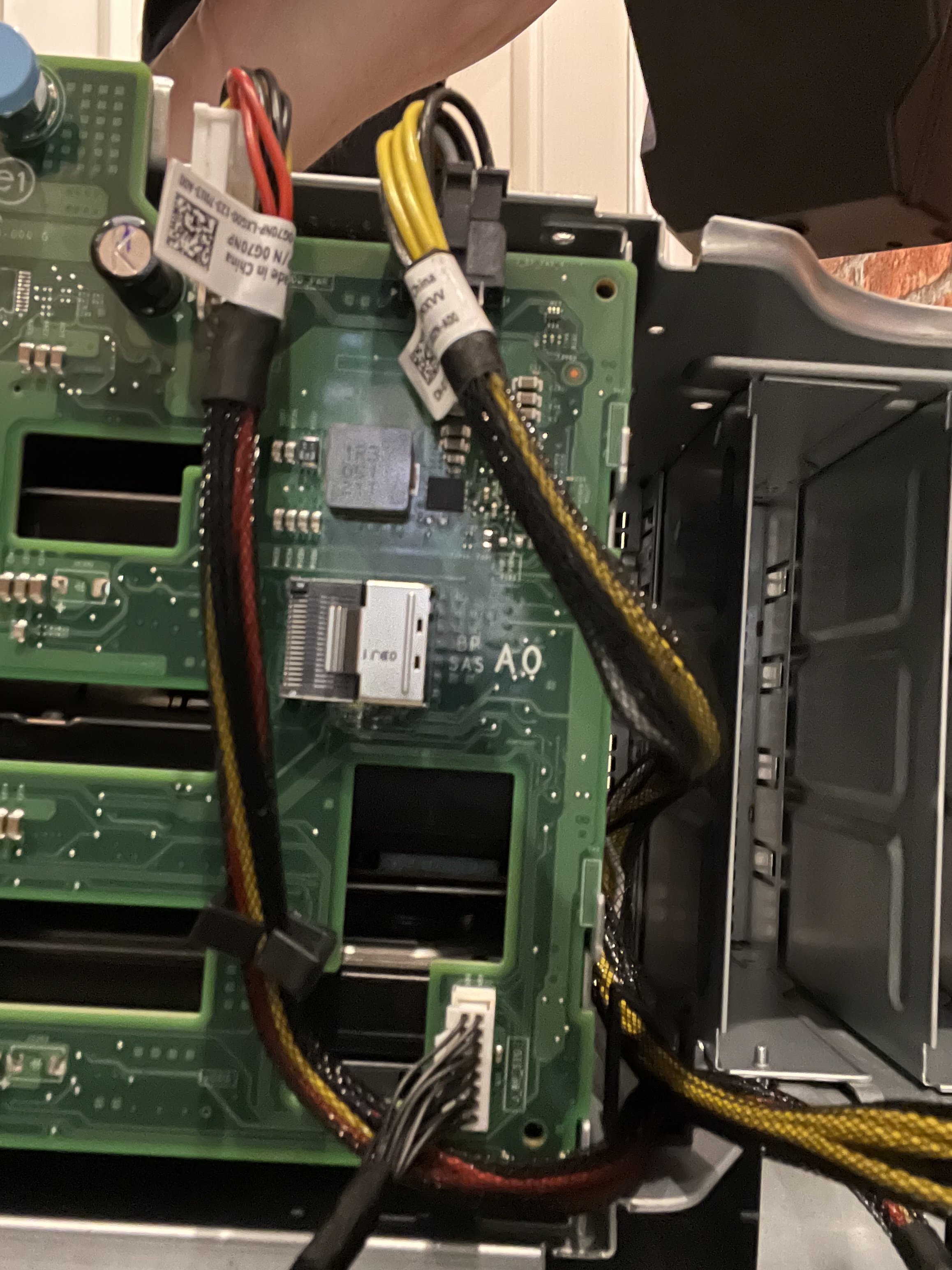

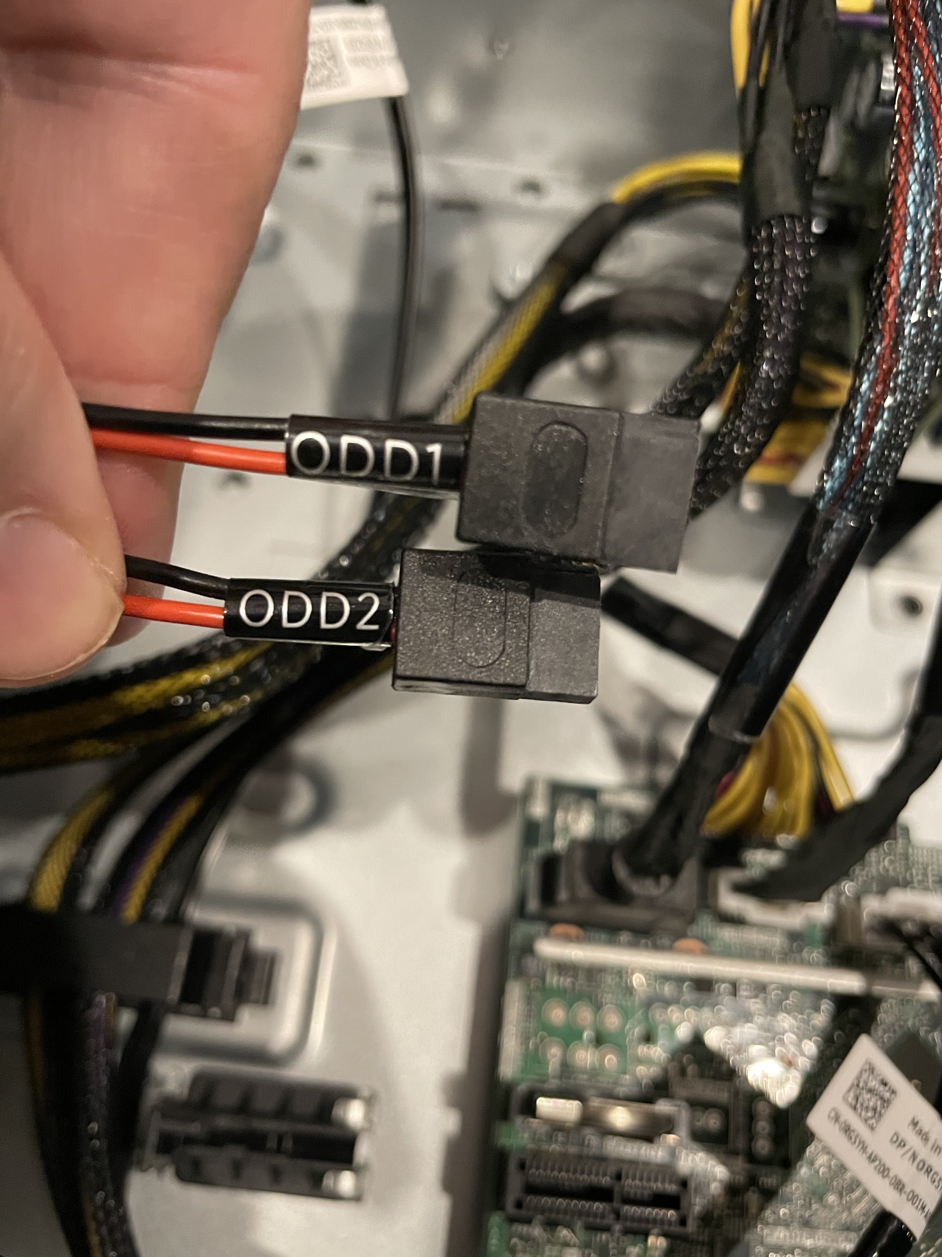

So, opening the machine up there are three cables from the Backplane. One goes to the PSU, one to the Motherboard and a third splits into two and are labeled ODD1 and ODD2 which are not plugged into anything.
I am hoping the issue is the server had a RAID controller in (A PERC H730P looking at the logs) and the cabling is still setup for this as I am
getting the error message:
The storage SAS A0 cable is not connected, or is improperly connected.
The storage SAS B0 cable is not connected, or is improperly connected.
I just don't know if it's the cable that needs replacing, or if the cable that is there needs to be plugged into somewhere else.

9 hours ago, Camnomis said:
Which seem to take the cables I have in my system
Those are slim optical drive power cables, you need SAS to SATA forward breakout cables to use an LSI HBA.

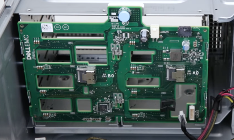

I am guessing that I need the cable to connect to BP SAS A0 and BP SAS B0 in he digram below (which would make sense with the error messages)
I believe the other end is Mini SAS (according to this) but searching Mini SAS brings up a multitude of different connector types, but it looks to me as if it is also SFF 8087 which means I would need something like this to connect it up (its a two pack of cables which again with 8 drives I assume I need both)
Yes, that's it.
