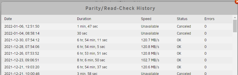

That makes sense,  I am watching it quite closely and all are running. I am a little confused by the log, it shows that I have carried out parity checks does it only log the parity check when it is finished? image.png.45dce04c61b8a4ba24150a2f22712326.png

2 minutes ago, madmanx said:
confused by the log
If you mean those logs from syslog server, sometimes they help and sometimes they don't. Syslog server doesn't really get going until after most of the boot process has completed, so those entries don't appear, but it is the entries leading up to crash that are sometimes useful in a crash. Sometimes nothing obvious is logged when this happens because it just crashes before anything can be logged.
