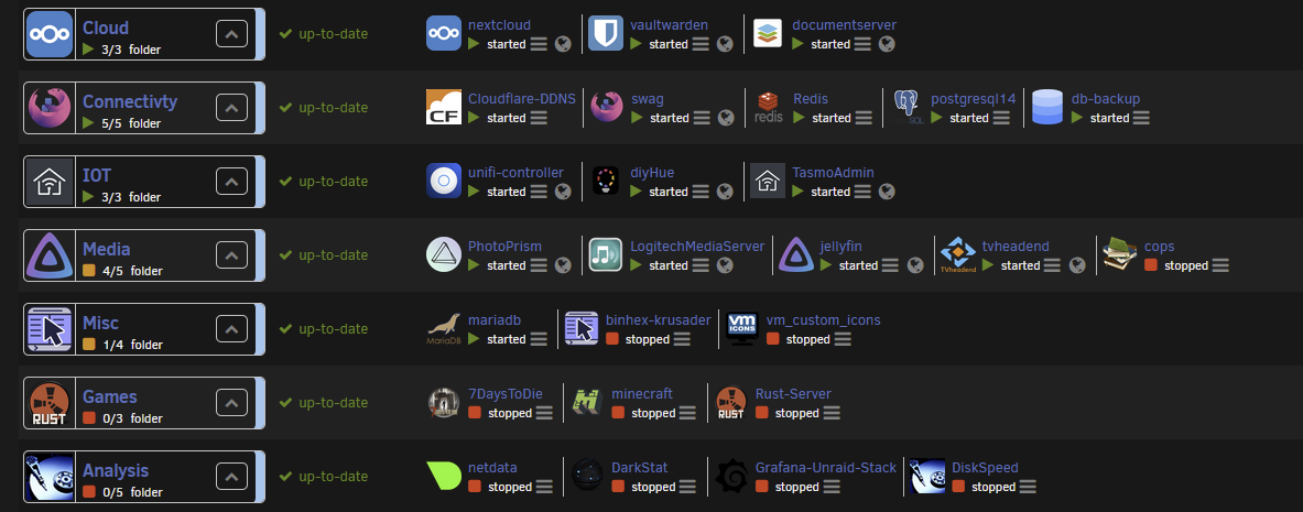

I seems that it is also not limited to a specific container.
It first happened with Prostgres 14 then I deleted the Docker directory and reinstalled everything
Then same issue with Minecraft and the next time with tvheadend and Photoprism.

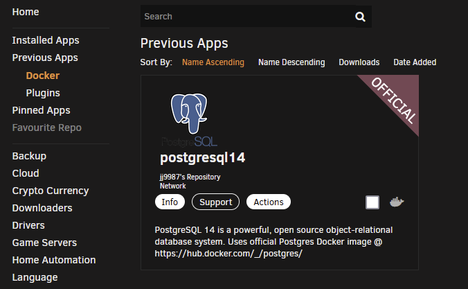

What I noticed, is that after installing all previous Dockers Postgres seems to be recognized as not installed, even that I've installed it and it's working.
Don't know if this is related?
