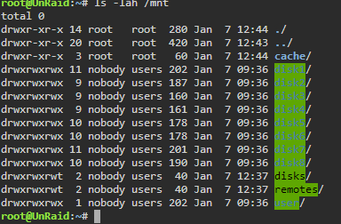

I probably screwed up your trouble shooting effort. I tried a reboot and got this. VVVVVV . Should i start up the metadata refresh and see if i can get it to crash again or just hesitantly update unraid? last time i tried to stay with the best version of unraid it crippled my system.
Do you have a cache drive assigned in the UI?  You've got a /mnt/cache but there should also be a /mnt/user0 folder.  And that will cause issues if it fills up RAM etc
I have no cache drive. on initial install i tried to run one but it never worked correctly.
You must have specified a path to /mnt/cache somewhere, probably a container host path such as /mnt/cache/appdata. You must fix that, since without cache, this path is in RAM, won't persist
